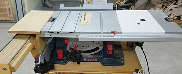

    The Bosch Table Saw won’t work, it does not turn on. I tried turning it on but nothing happens, no lights or anything. I am not sure what is going on with it.
    "If your Bosch cord or outlet has stopped working,, the next thing to do is find a different outlet or check if the cord has been damaged."
    I took the above statement from the manual. Unfortunately I couldn't find a solution to my problem. What are the recommended table saws you use?
    Click image for larger version  Name:	Screenshot1.png Views:	59 Size:	242.0 KB ID:	851657
    Giving that this forum started off as bt3central.com focused on the Ryobi BT3000, BT3100 and related saws also known as the BT3x00, the reccommended saw is obviously going to be the BT3x00, however those Bosch job site saws are nice in their own right, so why not try to figure out what is going on with it? No sense in throwing it out if it can be recovered and still used after all!

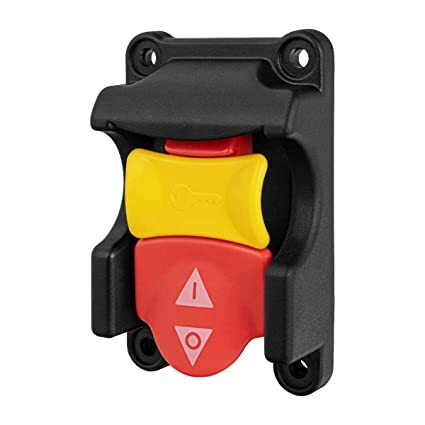

    Without having a manual on the saw, or great eyesight to see details in your pic, sorry I am not wearing my glasses right now... I can't tell if your switch is supposed to have a lockout key in it, but I do not see a yellow lockout key in place. Depending on the switch design, I would expect to see something like the yellow part in the switch shown below... (That is a generic version of the style of switch newer Ryobi saws use, as well as a mess of other MFGs...) There are two main styles of modern safety switches for table saws, and both include a lockout. The other kind that has the red key are typically more of a toggle switch where the key inserts into the, well, nose of the switch...
