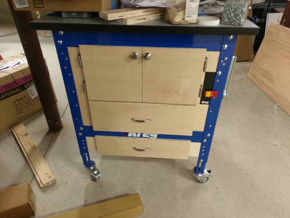

            I want to show what it looks like now.
            Sent from my HTC 10
              Just me
              • 8441
              Looks kinda like mine did - the table top is a magnet for anything and everything not router related!

                Correct, I am building a mitre saw table now and need all the flat space I can get.
