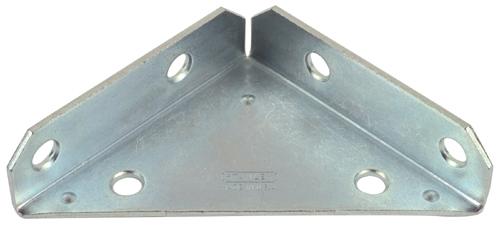

                              The assembly squares that CocheseUGA mentions are indeed handy, but can be expensive. Here's a less costly alternative that works just as well. (But see post #12 for a caveat.)
                              EDIT: I don't want anyone to be misled by comments made elsewhere in this thread. As mentioned in my original thread, one of the eight Stanley brackets I bought was way out of square. The other seven, however, were dead on. The bad one had a manufacturing defect that would have been glaringly obvious had I taken a few seconds to examine it in the store. On a subsequent trip to the same store, I spot-checked a number of other bracket sets -- the liquidator had dozens of them -- and found none that appeared out of square. So I consider the one bad one I got a fluke, an anomaly. Lastly, the steel the Stanley brackets are stamped from is fairly thick. That, combined with the radius of the bend on the two flanges, leaves a more-than-adequate relief gap for glue squeeze-out at the inside corner. This can be readily seen in the photo below, taken from the the first post of the original thread.
