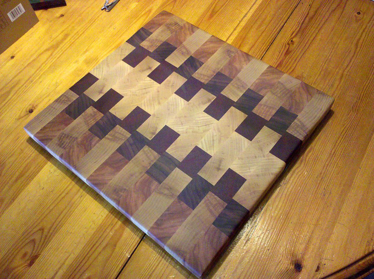

    For mine I used end grain, walnut/maple/cherry, and mineral oil. (I've made several like this and they hold up very well.)

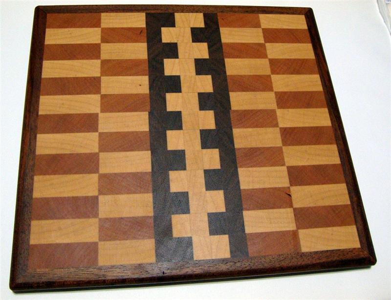

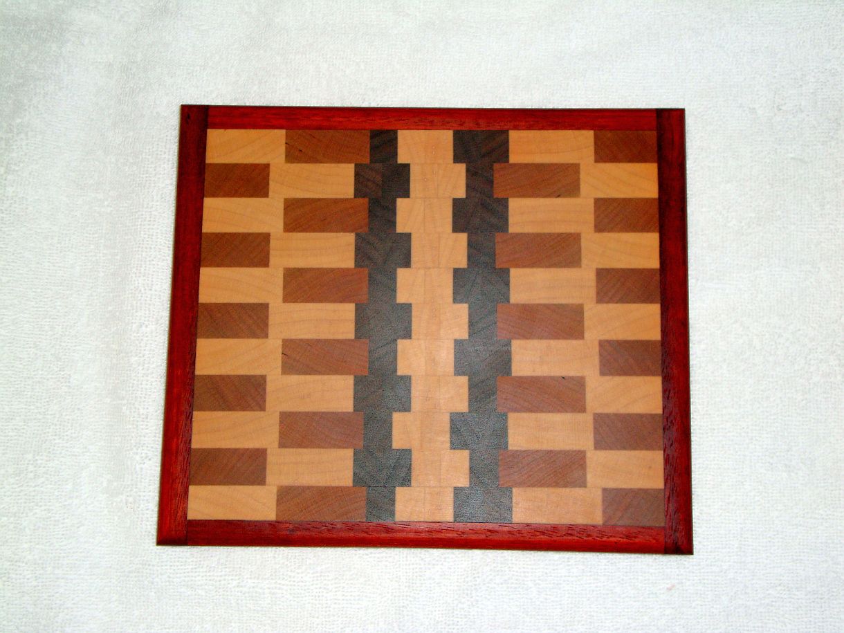

                          Don't give up yet. I had the same problem until someone on this very forum suggested that I NOT try to line them up. If you design the board without straight lines you can get some very dramatic effects and you don't have to worry about alignment. Some pictures are attached.
                          The first photo is one of my attempts at alignment that didn't work. The second is one of my designs with cherry, maple and walnut with a padauk border. The third is a picture sent to me by the chap who offered the suggestion. (I don't remember who he was and I apologize for that.)
                          I think I mentioned earlier that the biggest problem I had was getting a nice flat surface on the end-grain boards. It took lots of sanding, starting with #80 and working up to #180 or #220.
