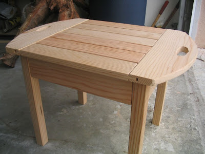

                a. A patio table :
                from free plans from plansnow : http://www.plansnow.com/freeplans.html

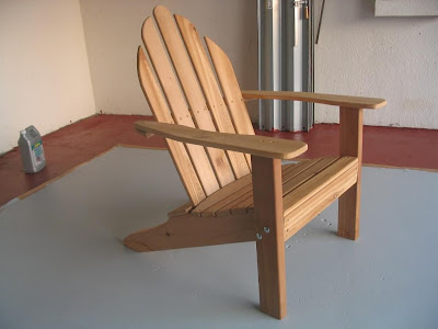

                b. An Adirondack chair :
                plans by the Norm : http://www.popularwoodworking.com/ar...rondack_Chair/
