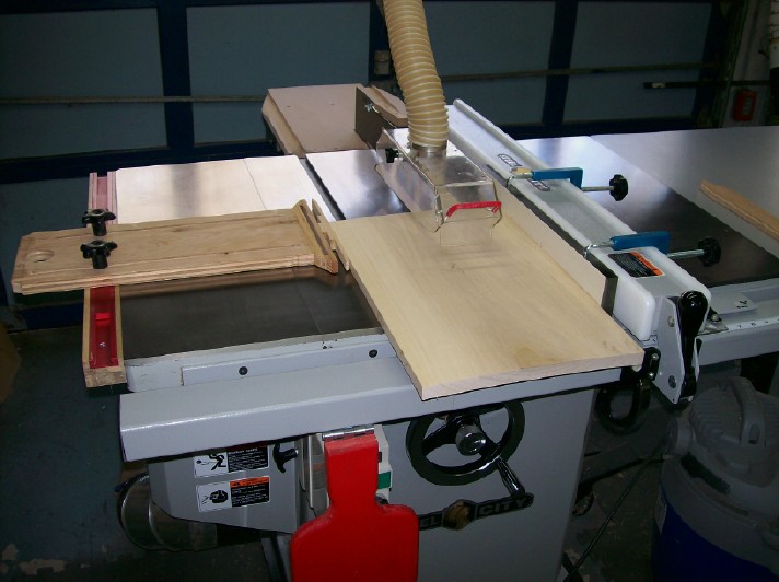

    Hello all, I am new here and very interested in building an over arm blade guard for my Craftsman version of the BT3. I don't want to reinvent the wheel and I am hoping that someone might share what they have done Thank you - Jim
    Welcome!
    You might just have to reinvent the wheel. I don't recall seeing one, or anyone speaking about using one for a BT3 or 21829. I looked through many posts and articles in here when I got mine from sears. There's been a little discussion on other aftermarket over arm guards.

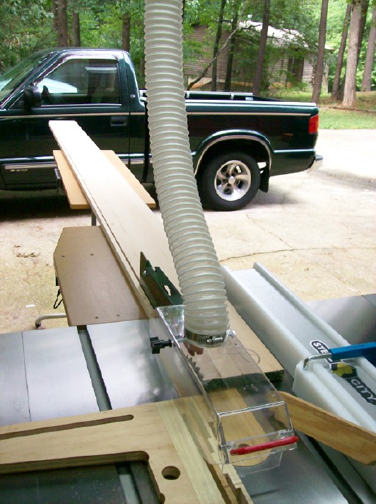

    Have you seen Leestyron's Shark Guard? http://www.leestyron.com/ I didn't like the guard that came with my 21829. I hardly ever used it. My shark hardly ever comes off my saw, and the riving knife almost never. (except for dadoes and box joints). It's one of the best things I've bought for my 21829. It ranks right up there with the router lift I put between some half rail extensions.
    Any particular reason you want an over arm guard?
      I second the comment on the Shark guard. I made an over arm guard for my Bt3, but ditched it in favor of the Shark.
      There are Pics of what I came up on my webshots page, just follow the link under my name. This might give you some ideas.

          Hey there Erik thanks for your response no particular reason other than I had seen a picture somewhere of a set up that looked good. I am not a big fan of the stock guard and thought I would ask here for advise. This is not my main saw I have a felder KF700SP that has a really nice guard with good dust collection. I will check the Shark out
          Thanks again. Jim
          • Jimendo
            Larry thanks for the response I think I saw a picture of your set up sometime back and thought I would like to do something similar. Is yours the setup with the shark attached to it or did you scrap the arm all together? From the pictures I could not help but notice the bottle rack do you "brew" as well. I am getting ready to try my hand at all grain here very soon. Thanks for your help. Jim
              Ditto the shark gaurd even though I just modified my stock splitter even thougth I run a 5 HP cabinet but I believe any stock splitter I have seen can be modified with some careful thought...

                      Hello Sarge thanks for the comments. The Felder is a great machine but it has a 9' sliding table and latley I have been build small stringed instruments. Actually Cigar Box Guitars (www.cigarcitycbgs.blogspot.com if you want to see one) one day as I was walking through Sears I came across the Craftsman at a very good price (sliding table, router table very portable and I could use my old dado blades) It was a no brainer I treat the machine with respect and as many here know it's a pretty good machine...
                      I am going to get the Shark... Thanks again - Jim
