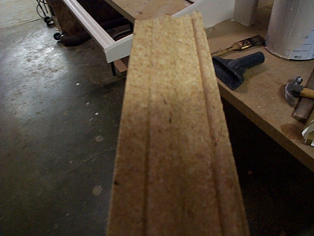

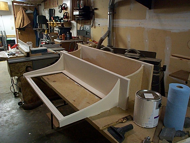

    I'm working on some projects with my grand kids and I'm using MDF (for cost control) I'm finding an issue that I have never run ac cross using real wood. After making a shelf with them and making molding I find that the MDF has many pits etc because it pulls out the particles rather then cutting them as it does in wood and leaves a very rough surface that needs to be filled before sanding. Wood filler is to $$$$$ to use that much of it. is there something else that others have used. Below is a picture of the project we are working on right know my grand kids are from 7 to 11 and I have started working the 11 year old on the router table and table saw under very close supervision. the other 2 do sanding and cutting on the scroll saw and bandsaw (supervised of course)

    I can't tell the size of the piece in your first photo, but that doesn't look like MDF to me. That looks like particleboard.
    Given reasonably sharp cutters, MDF machines quite nicely. At most a milled edge will feel slightly fuzzy as you run a finger over it. I don't thick I've ever experienced anything I'd call "tear-out" with MDF.

      yeah -- looks like particle board to me, too.
      If it's edges you're trying to clean up, have you considered iron-on edge banding? It looks pretty good after it's trimmed to size, and it's very simple to "install".
        • 9232
        Another notice that that looks like particleboard and not MDF.
        Particleboard is "Chunkier" than MDF and FAR more prone to tear out.

            I was thinking a plaster type filler too.
            That doesn't look like MDF either. It appears to be a type of strand board, the wood chips are larger than most particleboard I've seen.
              • 1865
              Perhaps this is OSB? Agree that the particles appear too large for MDF or particle board.

                Maybe I'm calling wrong when I call it MDF it is the same stuff they make prefab counter top out of. the edges that I'm having trouble with have been formed with the molding bits I have for the router. the saw edges aren't bad because I use and 80 tooth blade in the BT3000 and a 60 tooth on my breakdown table. the router bits work fine on normal wood. I'm going to try using drywall compound as I can get it in a gallan bucket from Lowes cheap. I don't know why I never thought of sheet rock mud, I've used enough of it.
                That piece in the first pic is a close up of 1 1/2" molding

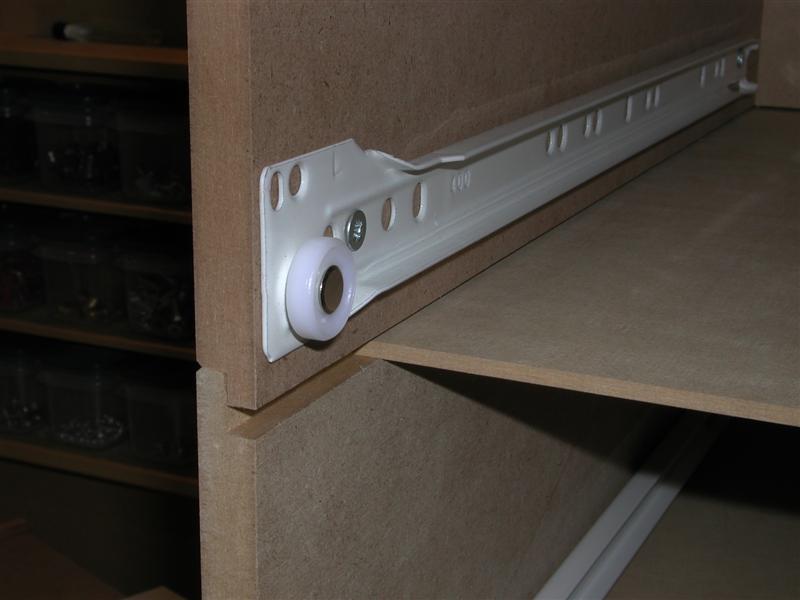

                  THIS is MDF...
                  1/2" sides, 1/4" "shelf" - routs and cuts beautifully

                    from your picture what I'm using isn't MDF Lowes best particle board is what it is. I'd like to thank every one here for all the comments and info.
