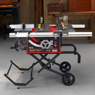

    I have a tablesaw (CM 21829) and a 6" jointer, but no planer. Both space and budget prevent me from getting a planer anytime soon.

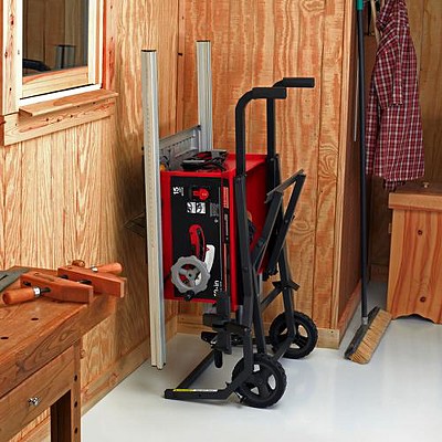

              When I say I don't have room for a planer, I am quite serious. my shop is 11' x 10'. In it, I have a workbench, 21829 table saw, large router table, miter saw, drill press and 6" jointer. I also have a dust collector which I keep just outside the door.
              Everything is on wheels and I roll one tool out at a time. When the tablesaw is not in use it is folded up and rolled to the corner. A great many tools and jigs hang overhead from the exposed joists. It feels a bit like one of these puzzles. If I add a planer, it will be the 16th piece and nothing more will ever happen.

                  If I wanted to store a planer under my 21829, I'd hurt my back lifting the table saw to place it on top each time I was putting it away! (I fold the saw up and store it in a corner when not in use)
