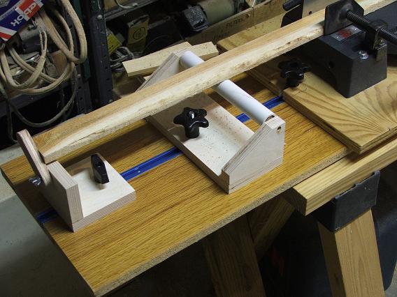

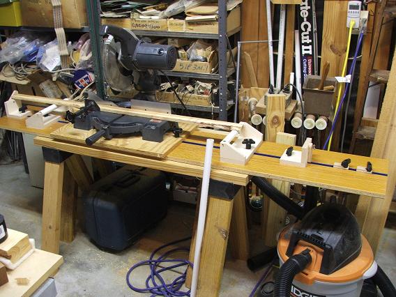

      I made this post some time back... easy, cheap, very functional and makes measuring easy. I will restore the rest of the pictures tonight...

        http://www.bt3central.com/showthread...ighlight=miter
        thanks for a great idea, I am a visual guy so will be looking at your pictures carefully.

                  I reposted the pictures in my original post
                  http://www.bt3central.com/showthread.php?t=20500
                  Read the detailed text and more photos there.
                  I made some improvements over the design shown at the very bottom below.
                  One thing that this design does not have that many DIY designs have is a fence guide that runs the length of the board.
                  I decided that wasn't really needed; if the board was straight the fence of the saw was good enough to get a right angle cut; if the board wasn't straight then no fence will help. My design (click for an enlarged view):
