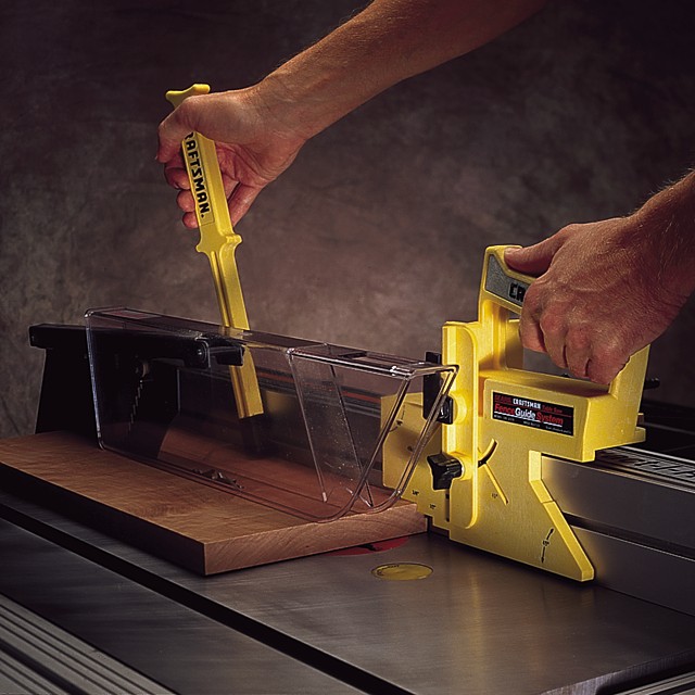

      I've done both but I get the best results with a tenoning jig. You get much smoother cheek cuts with a tenoning jig and it's alot easier to sneak up on the perfect fit. It's only recently that I bought one of the heavy cast iron tenoning jigs and I wouldn't trade it now.....but....it doesn't get used all that often and for years and years I got by almost as well with shop built tenoning jigs that ride the fence and this plastic unit that Sears sells
      This one is $19. I'd still be using it but it won't open up enough to fit the fence on my Griz. Pat
