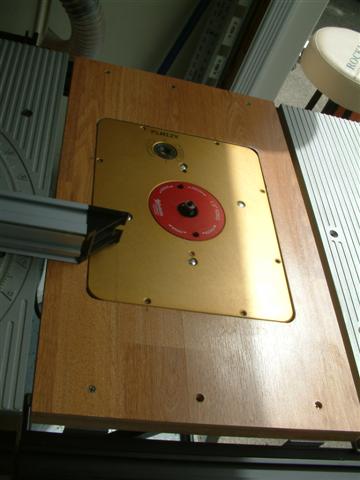

                      I would remiss without sharing that I used 3/4 MDF and laminate flooring for mine. I like the combo because it is dead flat and extremely durable. Here is a pic of how I did mine.
                      Scott
                      Edmonds WA
