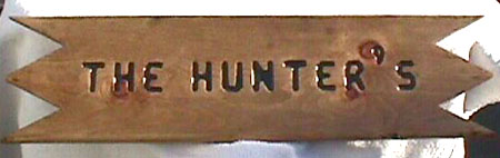

                              I found an easy way to blacken the letters. I use a sharpie marker, then poly the whole sign. Here is one made from a scrap piece of pine.
