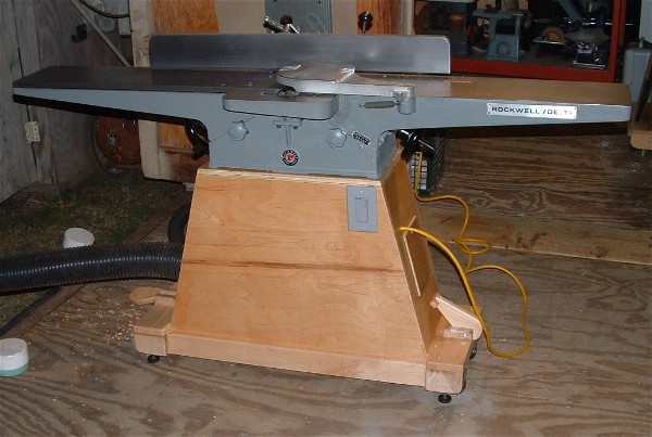

                          I asked some of those questions some time ago ago. I've used the stem casters for a flip-top planer base. Haven't had any problems so far. I bought them by accident and was pretty determined to use them instead of throwing them out. If I have a choice, though, I'll go with the other type.
                          Gwyneth, I echo what everyone else said regarding 4 swivels vs. 2. I made a jointer base with 2 locking swivels and it's been really hard to maneuver in my dinky shop. (I'm betting my shop is smaller than yours.) For the table saw, I used the Woodcraft base and that's been really stable. They were also recently on sale. At $50, it's almost as expensive as getting 4 good casters.
