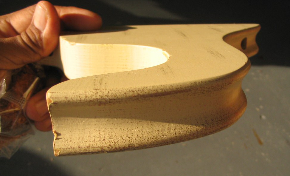

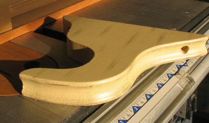

    LOML found that she wanted a copy of the brackets for our kids' bedroom drapes, but could not find it in stores. The original show below.
    I told her that I could make a pair for her, getting the general curved shape was not a problem.
    But how do I make the groove along the outer curved edge? Anybody have any ideas?

    Speciality Router bit? - something like a drawer pull bit

      How about a cove bit that is 1/2 the size of the cut?

        Gonna take something on the order of what Rod pictured. You'd never get a cove bit in there like that. Try going through here and see if you can find something. http://mlcswoodworking.com/shopsite_...l?src=googlead Pat
          • 8807
          I believe it was probably made with pattern bushing on a shaper bit. Even if you do use a router, you will need a pilot bearing and 1/4 inch shaped pattern.

              Here's your chance for a new tool. Carvewright with a ball mill.

                My answer would depend on how many you need to make. I could see making a quick scraper in a jig that you could pass over the piece through a bunch of times until it is scraped down to the correct profile. That is the route I would go for 3 or less.

                  The proper tool here is a shaper. If you can locate a right-sized router bit, can be done on a router table.
                  http://www.grizzly.com/catalog/2007/Main/468 - see 'internal radius' bits. Available in 3/16, 1/4, 3/8, 5/8, 1 1/8" cutting radius. If the groove is shallower than a full semicircle, you'll need to do one of the following:
                  Install a larger guide bearing.
                  Enlarge the bearing by winding thin strip of tape around it.
                  Then, use a beading bit to round off the edges.
                    If you could give some dimensions of the entire profile, like overall height (thickness), width of the edges, and depth of the cove, might be of help.

                      A pilot-bearing bit with a pattern to guide it is something i have attempted in the past, though only with a straight bit. The speciality router bit seems nice too. The manual tools (spokeshave and spoon plane) are intriguing, particularly because i have rarely tried any 'manual' techniques yet and always wondered where they'd be used. Now i know.
                      Had to google 'Carvewright' to see what it is. Will have to play more of the Lotto for that.
                      The original piece is 1 inch thick, and fits a 7" x 8" blank. I think the groove is about 1/8" deep.
                      She just wants one pair, and today she also doused my fire with a 'nah, i am not bothered with that groove, i just need that general shape'. I shall still try and see if i can manage this.

                        OK, this is a suggestion more for seeing what people think of it than saying it is the route you should take. It will be a lot more work than finding a bit or using a shaper, but it may work. However, I'm new to all of this, and want to find new ways to accomplish things I don't have the exact tool for.
                        What about doing it with a table saw? You could center the piece ove the blade and make the deepest cut. Then lower the blade a little and cut a little more, and so on out to the edges? When it is all done- you could sand it down to make it nice and smooth. Sure it's multiple cuts, and requires work and precision and a careful hand- but it may do just fine in a pinch, don't you think?
                          That would work (albeit a little tediously) if the piece were straight, but not with it curved in the other direction.
                          Knowing the thickness (which I had guessed must be about 1" to 1-1/4", from looking at the pictures), I'd make a pass on each edge with a bullnose bit and do the middle with a fluting (internal radius) bit. It might not exactly match the original but with the appropriate sized bits, it'd be close enough to pass all but the most discriminating of inspections.

                            I would consider dropping the grove part of the profile. It will take as much time and/or money to get that, as it will the entire rest of the piece. If you just cut it out with a jigsaw then round over the outside, you can knock it out in no time.It comes down to how much you like it.

                              I vote for this approach.
