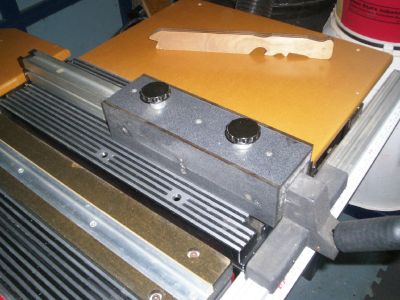

      Your BT (if that's what you have) has a slot at the top of the fence. I built my short fence by mating 3 pieces of MDF with glue and screws into a upside down U shape or a 3 side retangular box if that's eaiser. Then I cut 3 pieces of phonelic and added them to the surface by drilling counter-sinks and ataching sheet metal screws. Then you drill 2 holes in top that correspond to the center of the track on top of your existing BT fence. Slide a reciever nut in there or a T nut bolt and it mates to the holes on top of your home-made short fence. Two knobs with female reciever threads screw to the T bolt now sticking through.
      I made mine exactly 1" thick (3/4" MDF and 1/4" phonelic) and for a reason. By adding the sub-face on the existing fence I have thrown my rip scale off by 1" if I used a 1" thick subface. So... one of two things has to be done to correct that.
      (1) Be sure to remember to add 1" when you set the scale. For instance if you want to rip 2 5/16" wide, you have to remember to set the scale to 3 5/16" wide to compensate for the distance lost with the sub-face,
      (2) And the easiest as I did is to get one of those adhesive backed 72" long tapes at Highland Woodworking or wherever and add it over the existing stick scale. "Bingo".........
      Here's a little closer look at the fence isolated to get a better picture. Look at it carefully, remember what I described and let your mind run wild. You will grasp the concept.

      Pics of "home brewed" Eurom short fence and home-made crown guard below:

          The short fence is new to me, make sense. It's more important to have extra fence up from to get a straight cut than in the back, as that's after the cut.

            You're welcome Sarge. Well it's really a simple concept so wasn't too hard. I really like the idea though and your design couldn't be any better I don't think. I had something a little different in mind but after seeing yours close up I think I'll just copy it. So thanks for the pictures and telling us about it. Glad you decided to look at the forum this morning before consuming 4 gallons of coffee. I too consume quite a bit of the stuff in the morning myself, well actually all day long but the doc has got me on decaf. It really sucked at first not getting my caffeine but I'm used to it now and need it and like it almost as well. You notice I said almost. Anyway it sure looks like you got your money's worth and then some. Good for you. Hey that is one sharp looking push stick you got there. I assume you made it. Nice job.
