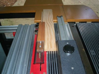

                  So Sarge what are you showing us? Is that piece of wood just that. A piece of wood or is it somehow connected with your fence. Sorry, not quite understanding and I like to learn so if there is something I can pickup on here I'd like to understand unless you are just showing us the standard fence on the TS? Don't mean to keep you from your coffee and chairs though. On second look, what is that thing on your fence anyway?

                    I think the pic is to illistrate that the fence stops at the blade. so there is no fence for the wood to be pinched against leading to kickback.
                      I understand what you're saying, Sarge. And it's very valid in your case. But most of us don't have the setup you have. Undoubtedly you have a lot more ww experience than I do. I just can't see the high fence not being more inviting to kickback in my situation. That doesn't mean my mind can't be changed. But it will take some convincing.
                        ICM...
                        I've got to wait for my wife to leave for her brothers as I have to caulk an un-ventilated tub with silicon caulk before the chairs get attention. So.. I'm around till just after noon and saw your response while checking e-mail.
                        Onedash has basically nailed it, but I will give the fine details.. The piece of wood shown is completely cut and the saw is turned off. Notice that the final cutting motion is accomplished before the last of the stock has reached the center of blade (or highest point of blade which is center in it's arc). Those front down cutting teeth do the work, the "rear rising" teeth serve no purpose what-so-ever in the cut, but they are a key element of the danger involved. If the operator shifts improper pressure to his feed.. or if the wood has tension and opens (tension wood closing after the cut and pinching the back side of the blade has another solution) the stock can hit the rear of fence and rebound or deflect it back into those dangerous "rear rising" teeth.
                        The short fence eliminates that potential problem by creating a "free zone" beyond the last teeth that arer actually needed to complete the cut. Take a close look at a cut you make and stop the saw as soon as the stock has been completely severed. Take notice of what position on the blade that happens and then ask why do I need a fence beyond that point that could cause interference that could lead to kick-back?
                        To go a step further in explanation.. take a look at those knobs on top of my "short fence" that actually fits over my standard long fence. They allow the fence to move forward and rear-ward by loosening them. And you will probably ask WHY?......
                        If you use 1" thick stock the final tooth needed will be around the 2" from the front of the blade going toward center. If you use 1 1/2" stock, it will be around 2 1/2" from front of the blade. 2" stock.. etc., etc... But at no point regardless of thickness will a NEEDED tooth be involved beyond the highest center tooth in the arc. I have a position mark on my saw to indicate where I need the front lip of my short fence without having the fence extend any farther than truly needed.
                        So.... it took a little getting used too when I first used the short fence (about 200 practice cuts on scrap) to get the proper feel, but once I attained that feel I would never use a long fence again. A short fence can be adapted on any U.S. saw with a long fence. But will the merits of the short fence be recognized and adapted? The way people have done it because that's the way it's always been is hard to dent. But.. the short fence is a safer way to "get er done" and that's a fact as you will not see a long fence on a European saw unless it's strickly for export to the U.S. They are very safety oriented and that's why they all have riving knives instead of the standard splitter. And those pawls which I almost severed a finger on once as the gaurd dropped down when raised and took a bite. And the saw was not even turned on.. I have never used a pawl since.
                        So... if you have further questions, I will get back to ya latter. Let the silicon stink up the joint so I can get to the shop where the coffee pot awaits this fine Sunday morning. Amen!

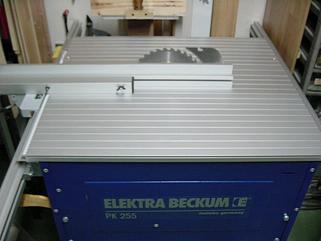

                          Just to strengthen SARGE, Look at the pic of my European TS.
                          The short fence can de adjusted fore and back.
                          Please have a look at this page
                          http://forums.ukworkshop.co.uk/viewt...b4af67eb3b6d1b
                          Look for "Scrit"s reply, he is an accident inspector/investigator in UK.
                          Here is part of his reply:
                          "To avoid trapping it is necessary to use the short rip fence which ends about where the blade gullet is - on a through fence this can be achieved by adding an auxilliary rip fence to the existing fence top emulate a short rip fence. Do that and trapping between the blade and the rip fence simply doesn't occur - a very good reason NOT to follow American long rip fence practice which was abandoned in the UK years ago. For me (trade) this is the law - for a DIYer it's advisable because it's safer".
                          Also, please click on the "here" at the end of his post, it's a safety PDF file of the UK, I recommend reading it.
