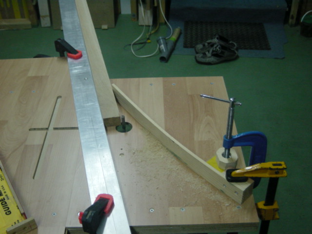

        In spite of the fact that everything went very smooth and easy for me because, as you could see, I was just “shaving” the board, I also agree with all of you that there is a danger of a kickback.
        Just for the good discussion, can you tell me what is the difference between this set-up and ripping on a table saw, considering the fact that so many people are even removing the splitter and guard because “they are on the way”.
        niki

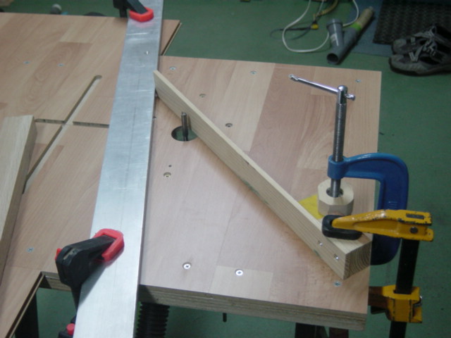

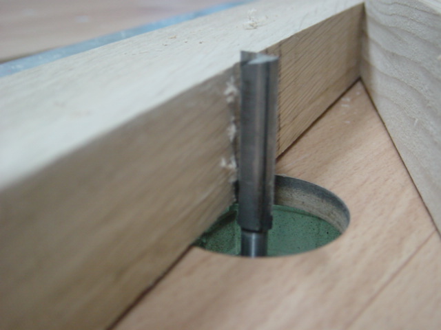

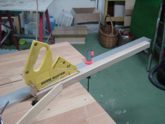

            After I posted, I went to the garage and made this set-up and I used narrow and long board.
            I made 3 passes, in one of them I stopped to show the amount of "shaving".
            As I said I did not feel any problem without the feather board but with the feather board it was even easier because I did not have to take care for the outfeed side but only to concentrate on the infeed.
            If you remember my "feeder roller", it can be adapted also for this task and it will keep the infeed and the outfeed sides pressed to the fence.

              The advantage niki's set up is consistency. If you use a fence that's off-set on the outfeed side, then deviation between the off-set and the amount the bit is sticking out would cause problems.
              With niki's set up, I'd probably put a guard around the bit, use the feather board, use a higher straight edge/fence, and use c-clamps, not those grip clamps to hold the fence. Shaving only a bit at a time a few extra minutes of set-up to make verify the depth of cut would minimize the risk of kick-back and provide a good servicable paralell jointing operation.

                        After re-considering all the factors and replies, I decide to remove the pictures and I strongly advise,
                        DO NOT DO IT,
                        it's too dangerous and the kickback can happen sooner or later
                        I will try to work on some different solution with split fence or so.
                        Thanks to everybody that replied and helped me to make-up my mind.
