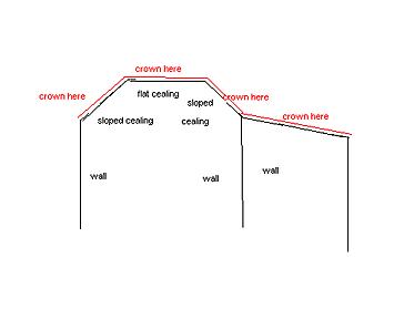

    Howdy fellas. Need some help with some crown molding. Is it possible to put crown molding where the cealing has been vaulted and the wall and cealing are not at 90 degress to each other below is a sketch of one of the walls:
    The black is the shape of a side and end wall and the red is where I would like run the molding. None of the angles are even close to 90 degrees except where walls meet each other. I have been searching google for crown and vaulted cealing, but have been comming up with resutlts where the cealing is v shaped and I have more of a "barn" shaped cealing. Any ideas would be greatly appriciated.

    patience and a good angle transfer tool. . . .

      I dont think the crown molding should go where your red line is...because there is a flat ceiling in the shape of a rectangle I would guess. If you are putting the crown molding at top of the flat side wall why are you going to go up along the end wall? Have you thought about keeping it flat and on the exposed wall just capping it off? Hard to tell by your picture but you will be puting crown molding at two levels right? 8 feet on the side walls and whatever the height is for the end walls? The worst thing about this method is the angle from wall to ceiling is going to require either a different angle or two different sizes of crown molding because if you are going to close a 90 degree angle off with CM and you have it at 45 degrees what happens when you get to the vaulted part?

          If I read your drawing correctly the short answer is YES. You can put crown up and it can look classy. That is the shape of the ceiling in my dining room and we have crown installed.
          I think someone once called it a coffin ceiling.
          Oh yeah and the one thing that will make it easier and a success...
          Corner blocks, I think in this case they are required where the side wall meets the end wall (where it goes from horizontal to sloping up)

            On cathedrals and vaulted runs, I've made wedges for the miter saw to back up, or front up the moulding to cut the miter on the moulding as it stands or positioned to a verticle surface. I dont recommend this method, as it is one that does not entirely immobilize the moulding. If the moulding can be clamped to the saw in proper position, then it works pretty good.
            Otherwise as in this link, deriving the angles for the miter, and the bevel will allow the moulding to be cut flat to the bed of the miter saw. Here's a few links that may help.
            http://www.josephfusco.org/Articles/...ownscript.html
            http://www.mountainmoulding.com/inde...%23RequestList
            This link would apply more to vaulted and cathedral:
            http://www.compoundmiter.com/cathedral_ceiling.html

              Cabinetman and cheeky to the rescue!!!! Of course onedash had a good idea with getting Tom Sylva to do it, but they don't seem tomake it down to texas all that often on the show, but that would be real cool. jAngiel, I had thought of corner blocks but I had used them in the living room, dining room and soon to be den. I was wanting a different look if possible, but haden't ruled them out yet. Cabinetman- great links!!! I had thought about using extra trim on the tob and bottom as in the one link, and I might still do that. And the video was awesome cheeky! Some of his tips I dom but some seemed so obvious that I couldn't believe I wasn't using them already!! This will prabably be the last room I do the crown in, but I like to start planing early. I already know how I am going to do it in the other rooms and not having ideas for this one was killing me.
