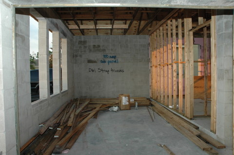

    Hoping you guys can help. Building a new house and I have a single car 11x21 garage (pic below) that will be my dedicated workshop. Going in there, I have a BT3100, Delta planer, HF Bandsaw, router table as far as the larger dust makers - eventually I'll get a jointer. I do have a big Ridgid Pro 6.5HP 16 gallon shop vac. I'm considering purchasing the JDS 750-ER air filtration system to capture airborne dust http://www.amazon.com/JDS-750-ER-Fil...&n=228013&s=hi . I dont think I can swing both a DC & the air filtration right now (mainly budget wise, but would appreciate the extra space too if I didnt have to give it up to a DC). Given that I have the heavy duty shop vac - should I get the JDS AF first? Can I even get away without a DC (i.e. is the shop vac enough)? I will be working with MDF quite a bit as well as hardwood. Thanks!

    actually, you'll need both. DC cannot capture all the dust.

      If you only have funds for one, I'd suggest a DC first. You actually would be better off with both in that small a space with MDF. Point of use capture make the DC my first objective but it needs to capture smaller particles to be of worth.

        Thanks guys. As far as DC's go - what do you all like for a shop this size? According to Taunton's 07 Tool guide - the Delta 50-760 got best value and best overall (1 micron bag included) at $320 - also included are the Grizzly 1028Z and Jet DC1100A - but you needed to buy better bags. Any feedback on which to get? 1.5HP good size for this shop?
