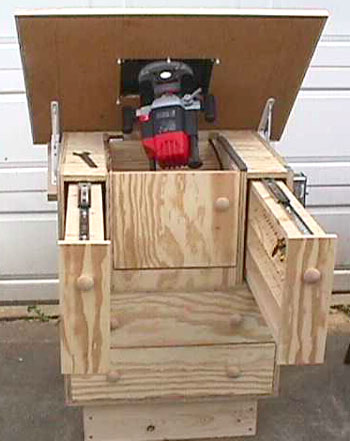

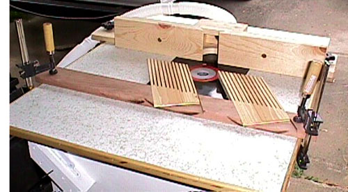

      I agree with sweensdv. Since you already have a router for doing the hand held jobs get one with some real power for the table mount. Say in the range of 3 - 3 1/2 HP that will take 1/2" shaft bits. Building a router table is also half the fun. Here is one I built using the plans from Kreg Pocket Hole Jigs
        [ATTACH]2985[/ATTACH]
        [ATTACH]2986[/ATTACH]
        that's impressive, I am a relative beginner.
