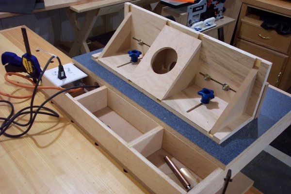

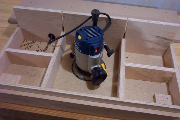

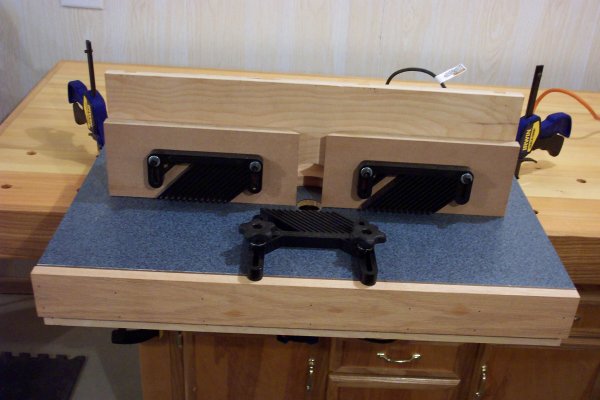

                I used the PopWood article as a guide to make mine. I needed something with a larger table than what the BT3 offers, but I wasn't ready to dedicate the time or material to a "real" router table. It's all made from scrap or recycled material. The laminated particle board top is from a cutout for a sink.
                I routed about a 3/8" circle to accomodate the router base, marked the holes to attache the base to the router table, then chucked in a bit and plunged a hole.
                In the long run, a dedicated table would be more handy, because it still takes up the same footprint. Plus, it's heavy. It works great, though.
