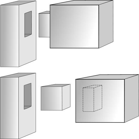

              Perhaps this will help?
              Top drawing is a conventional mortice and tenon joint, with the tenon being part of the right-hand piece, the mortice cut into the left-hand piece.
              Lower drawing shows a "loose" tenon (the central block), which fits into mortices cut into both the left-hand and the right-hand pieces.
              Loose tenons can be square, rectangular, rounded over, whatever - as long as they are an accurate fit in the mortices. "Loose" does not mean that they fit loosely, but that the tenon part is loose - i.e., separate from the other elements. HTH
              Ray.
              Did I offend you? Click here.
                Ray.
                That will clear up any misunderstanding of the varied definition of "loose".

                  Great I got it. I sure wouldn't have ever thought though that those two completely ( at least to me ) joints would have names so alike. I think they should be named differently. Oh well. Anyway thanks all for the help and while I finally got it the pictures confirmed it. Thanks Ray.

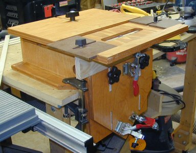

                    Mac,
                    This one of the best mortise jigs I have tried. It takes a little time to put together, but once setup for a given mortise, you can knock out many in a short time. It's from Shopnotes, a few years back.
                    Ken
                      Cabman & Ray,
                      Thanks for the explanation and the the pics. Cabman's explanation was dead-on - like the others! But, I have to admit, that until I actually saw Ray's post with the pictures, I was still tossing this around in my head trying to figure out the difference.

                          That is some rig Ken. Thanks for the picture. I'll have to take a closer look at that jig if I decide to try them. Yeah LarryG integral tenon would be more descriptive - and let's kill that loose tenon name. how misleading.
