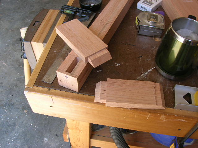

                              I think the only way the glue was comming off is because the tennon was two big. I always tend to clamp things as hard as I can...I haven't done to many M&T but the tennon has almost always been too big so I shave it down a little, bang it in, bang it out shave a little more off and so on way to many times because I am scared I am going to get it to small and then its to loose. Then I probably put way to much glue in it, clamp it up and call it a day. I made about 38" tennons I think they were on my kitchen table for the bread board edges. I didn't have clamps long enough so I used two pocket hole screws underneath.
