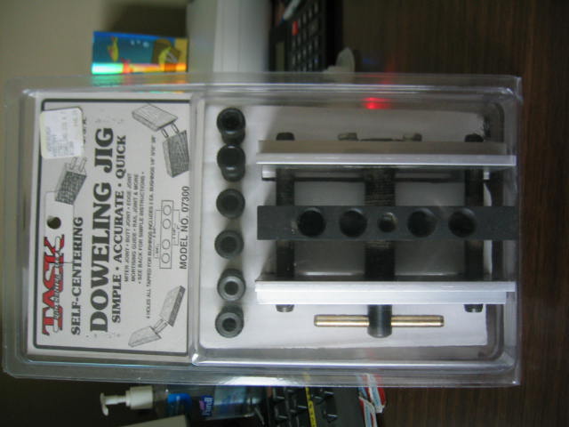

        iv'e got a dowel jig from Task pro center usa.
        the model is 07300 it has 4 holes and 6 bushings that screw in. it is self centering and has the holes spaced so you can attach the jig once and drill a couple of the same size holes at either 3/4 2 3/4 1 1/4 2 inches apart. i used it to drill all the holes for my sons crib i built and it worked well. haven't used it after that though. it was one of those tools i bought for that particular job. (that's how you do it, right?)
        i paid about 40 bucks at the local ww store. might be worth checking out.
