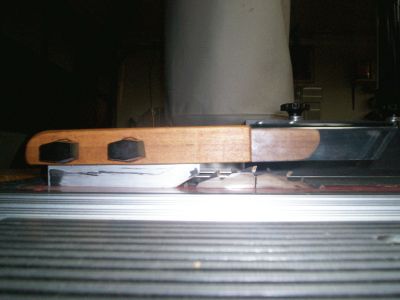

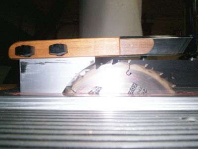

            Thanks. I make all of these myself. I currently cut them out the old fashioned way with a metal bandsaw. I have a plasma cutter now and want to CNC it so it will be able to do the grunt work for me in the future.
            Your guard looks good. A couple of other guys use the same basic approach around here. The most important feature to me of any guard is that RK. It can absolutely save your hide.

                I've had my Shark Guard about six months now, and I have to say it is one sweet piece of equipment. Nicely made, elegant design, and top-notch materials. It's an essential accessory even at twice the price. I can't believe I waited so long to buy one.
                Plus I love the shark decal.....

                          I have actually evolved the shark to fit the Saw Stop. There are a few differences in the OEM guard and extra true riving knife and the Shark.
                          For starters, the guard is really too narrow. Why too narrow you might ask? Well being narrow is good, but the guy that helped me with the Beta version sent me his brand new replacement guard that he had to buy. It seems his original got cut into by the blade pretty good, simply because it is so narrow. That really isn't desirable. Also to get a true riving knife like the Shark has, you have to remove the blade guard and throat plate. Then install the true RK that comes with the saw. It's not hard to do, but it's easier with the shark I think. One RK stays on the saw. Also for some reason the true RK on the SS is pointed at the top. Not much meat there when you have the blade set low. I do like the pawls on the SS guard, but with the Shark and a RK, I feel the pawls are redundant. Good for those that want them. Dust collection is a factor as well.
                          The Shark Guard just has more features than the SS blade guard.
