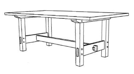

      If its a trestle style table, you could consider a cross member with mortise and tenons (like the pic below). If you'r put off or intimidated by the sliding dovetail (which I would be) it might be a good start.

                Members that connect legs, down below the table top, usually six or eight inches off the floor (although this can and will vary). See the picture that Ken posted ... there are short stretchers joining each pair of legs at each end, and then a longer stretcher between the two short ones.
