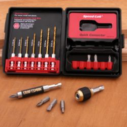

      http://s7.sears.com/is/image/Sears/0...7.128&fmt=jpeg
      Maybe that would work ok...
