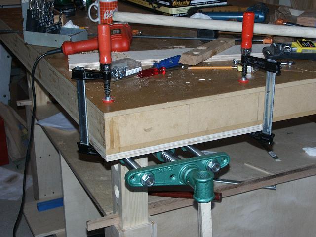

                        Thought I'd post a picture to show you how my assembly table is coming along. I still need to screw the top down, make an 8/4 ash apron, attach the vice and cut the dowels (for the heigth adjustment holes). Should finish this week if I can finally kick this sinus thing bugging me.
                        Gary

                          Gary, that looks spectacular! I'd be worried about it a little. It's too nice to work on, it looks like furniture already. I'm not sure I could bring myself to drip glue on it and make stains and cuts.
                          How will you attach the vise? Show pics, I need a lot of help in this area.

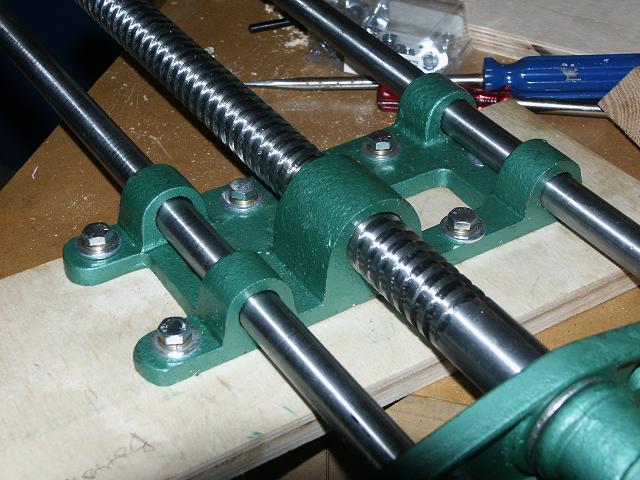

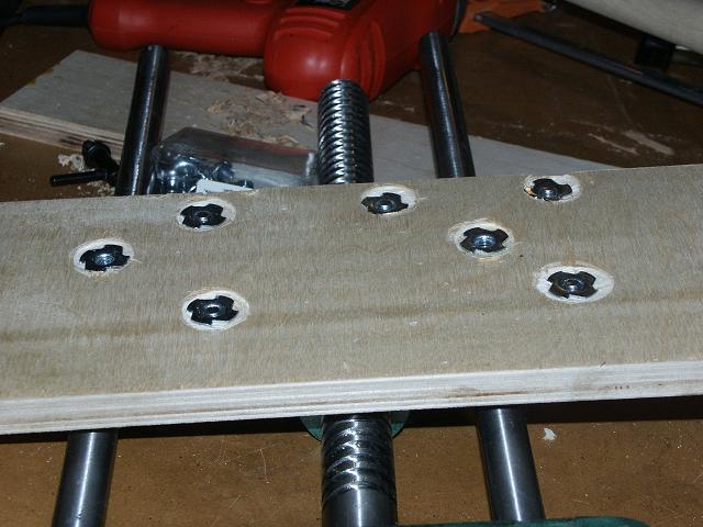

                            I'm new to the vice department myself. I've attached the vice to a 3/4" piece of Baltic Birch plywood with 5/16 bolts and T-nuts. 3 Photos below. The plywood edge will butt against the apron; I figure that will allow vice to transfer the force through the plywood directly to the apron. I will also pocket screw it to the apron and also screw it to the bottom surface of the assembly table.
                            I'm happy how it's coming out so far.

                              Good show, Gary! Thanks for the closeups. I read text and often get lost in the words. Picture make it much easier to understand.
