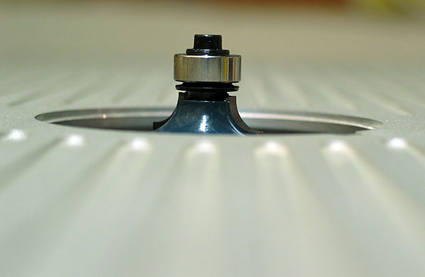

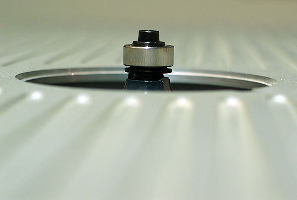

    I think Jamb is just using that slab of white plastic to simulate the thickness of the accessory table top + mounting plate. As pictured, the router is not mounted in the table so he's using the white plastic to illustrate the relationship when the router is mounted in the table. (But with that said, it doesn't look to me like the bit would have to be raised as much as the final picture shows.)
    There doesn't appear to be any protective coating on that bit to my eye, FWIW.
    That’s exactly right, on those pictures the router is not mounted yet.
    I made out a mounting plate of that white plastic cutting board. Yesterday I cut it in shape and attached to the accessory table. The next picture shows the router mounted in the table with the white mounting plate + black router base on. The last one shows the same setup without the router base plate (only the mounting plate is used). If I remove the base plate from the router I can raise the bit a little higher, but also remove the dust collector channel that is attached to the plate inside and connects to the dust collector port on the base. Is it OK to remove the base plate and leave the motor exposed to dust?
    Shouldn’t I be able to raise the bit fully above the table surface as the second picture shows above? I understand it is not necessary for round over but what if I want to include part of the vertical cutters in the design? How does it work in your table?
    (There is no plastic protection on the bit)
    EDIT: Larry, you totally understand my problem. Agent511 still doesn't get it. I don't know how to explain it. Maybe these pictures will help.

      Now that Larry cleared me up - and it was my fault for not catching on earlier - I think I have the problem understood. You made a table mounting plate out of the UHMW PE pictured, that is about 1/2" thick. You now have less exposure of the bit at full safe extension than you did with the original router base which probably was 1/4".
      So you would either have to get a bit extender, or you would have to rethink your choice of table mounting bases, and use something more conventional and not as thick.
