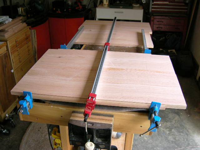

              I would take the time to use biscuits. Every glue up I've ever done has had a tendency to slip somewhere and they really do help the alignment. Another trick I've started using is to put two 3/4" dowels, about the length of the glue up, one on each side (see pic below, its a 30" long table top, the dowels are 24"). This puts the pressure point from the clamp exactly in the center of the boards being glued and there's less tendency for the clamping pressure to cause a bow in the glued up stock.
