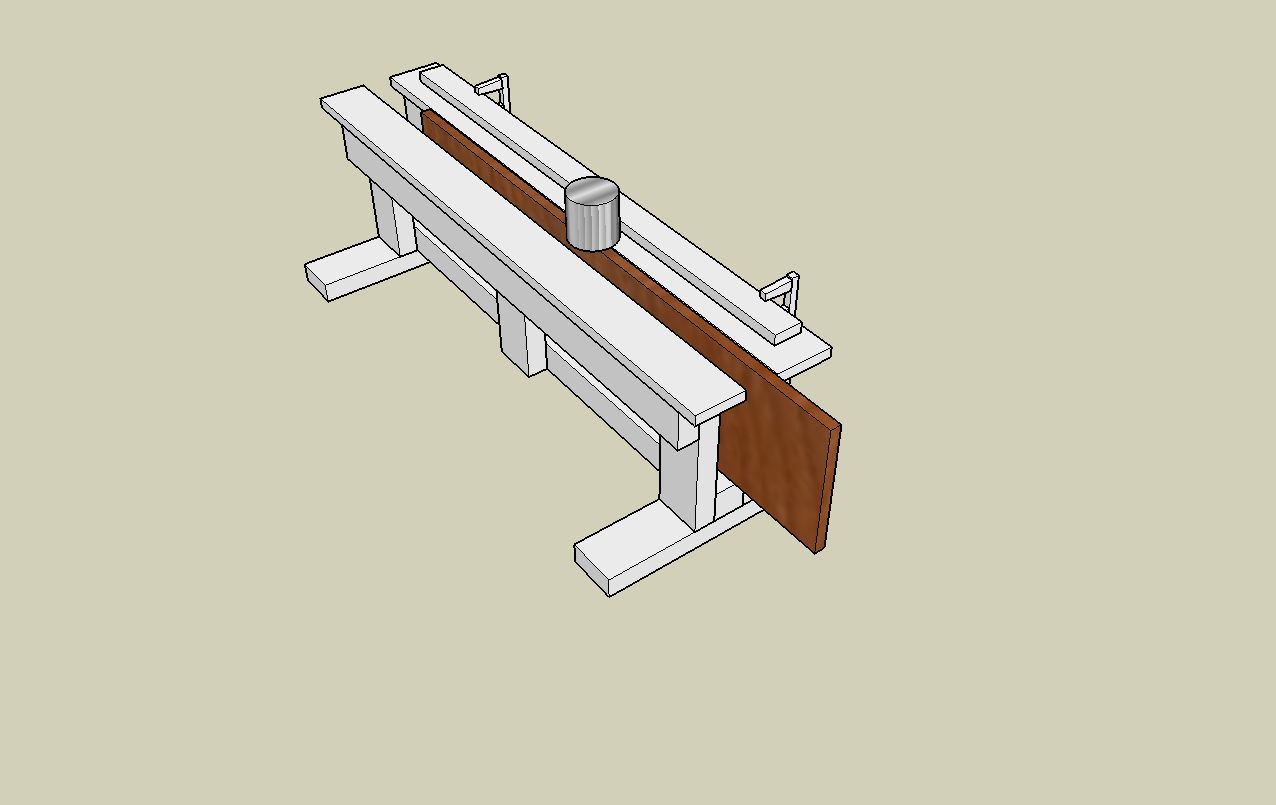

                In the meantime, since SketchUp is all the rage here, I will post the jig I built in lieu of a router table or mounting on BT3100. As for using the saw ala dado/rabbet, I was not too keen to take off the saw's blade guard, pawls, and riving blades as I seem to remember that being a pain when setting up originally. I guess I'll have to get over that feeling though. But it was a good suggestion, and one which I had completely overlooked... suffering from--ahem, get this--TOOLnelvision, I guess could only envision a router.
                Here is the jig I made. It actually works pretty decently on short scraps any way... tomorrow is the big day to test on the real pieces. Btw, I am connecting several pairs of boards together, not just one pair, in case it makes it less crazy.
                Here is the SU: (that little can is the router... it's not so easy to draw a router in SU!)
