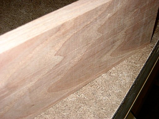

            Here's a picture of what I mean
            Loring, I've attached a picture of a face of one of the boards showing the strips thta I am talking about. These raised strips are each about a half inch wide (it is roughly a 5" wide board). They certainly are not from nicks in the blades. It almost looks like the blade was segmented rather than one piece across the width.

            It is more of a mystery to me at this point rather than a big deal. I've done the sanding and am on to the next step. But I will probably look elsewhere for hardwood in the future. Actually, now that I know what I should expect, I may go back to the shop with that remaining piece and ask them whether this is their standard finish to s3s.

              those are from nicked blades. I have even gotten some like that from woodcraft. I always run them through my planer though to get them to 3/4" usually so that takes care of almost all problems. I got a nick in my blades too. So I try to work around it if I can. If not I sand it off.

                the two lines running the length of the board are from nicks in the blades. the lines going across the board are from them using a feed speed that was too fast. they probably were taking off alot in each pass also adding to the problem..
                  Yup.
                  A wide nick (half an inch) could be from hitting a really hard knot or a mineral inclusion.

                    Production-grade planers, in my experience, are more likely to have a spiral cutterhead with carbide inserts, rahter than straight knives. If a couple inserts are worn out or missing, this could also be the reason. And while many planers include speed settings for 'dimensioning' and 'finish' cuts, the guys at yard likely just keep it on dimensioning to have things done fast.

                      I am looking at the picture and not seeing what the OP is seeing. I don't see a raised strip 1/2" wide. I see, like most of the others, two raised lines from two minor nicks in the blades. These should sand out, or better yet scrape out with a cabinet scraper fairly easy. A scraper costs a few dollars and is perfect for this type of problem. The smaller ridges running across the piece are from the speed of the planer. I think these also can be expected - I don't think we usually can expect or should expect wood to be planed to final finish.
