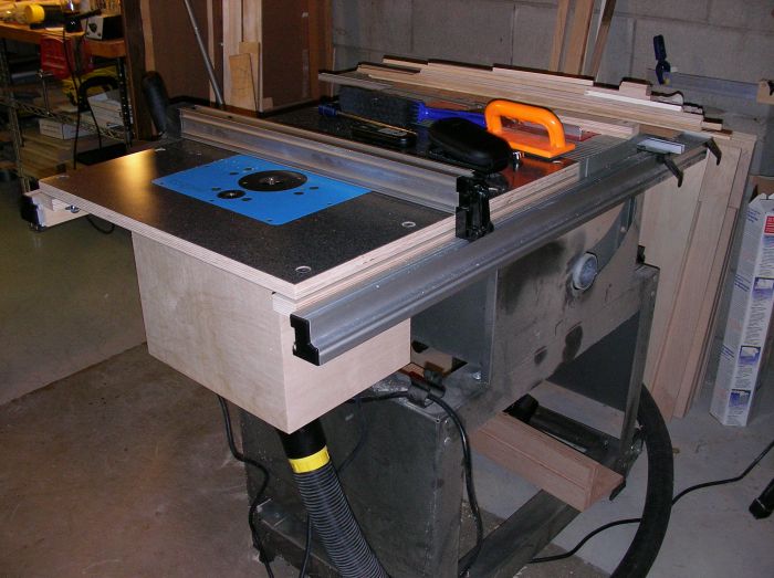

    Hi guys,
    I read in various places about folks making wooden table sections for the bt3k, either to make space for routers (which I may need) or to fill space for wide table kits. How are you attaching these pieces to the rails?
    Thanks as always for sharing your hard earned wisdom.
    http://www.wreckwriter.com/
    usually, Adjustable height angle brackets, attached to the T-slots in the inside of the rails.

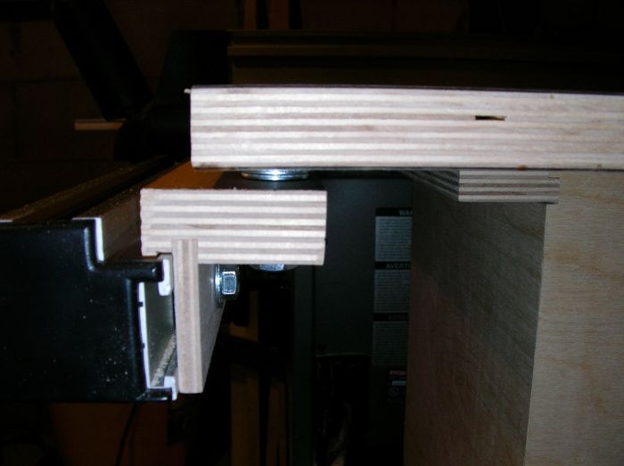

      My solution is unique, I guess. I've made plywood brackets that fit into the rear rail and onto the front rail, much as the standard extension table does. The beauty is that I can remove and replace my extensions without fiddling with adjustments. Also, there is no possibility of a bolt loosening and causing the table to fall under pressure during use, like some of the other designs I've seen.
      Thanks,
      Phil

        Cool. Adjustable angle brackets? Can those be had locally?
        Phil, that's nice. Are the wooden blocks attached with t-nuts and regular bolts?
          Yep, three t-nuts on the front rail. The rear rail doesn't need any, as the profile for the rear rail is just a 3/4" thick piece of plywood reduced to approx. .25" that slides into the rear rail the same way the Ryobi extension table does. Works perfectly.
