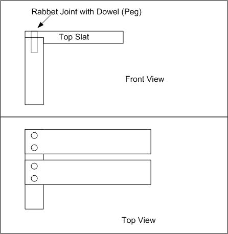

                You can make it look fairly impressive with a pegged rabbet joint. This would be very easy to do, like so:
Name:	Step Stool Joints.jpg
                Cut the joints, glue and clamp each slat in place one at a time, and drill the holes for the pegs afterwards.
