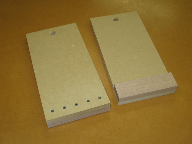

    The jig consists of two identical halves; the first picture below shows one half right-side-up, the other upside-down. Each jig half is just a rectangular piece of 3/4" thick MDF, sized as needed (mine are 7" x 14") with a hardwood fence attached across one short end. The only critical part of the jig's construction is to make sure the fence is perfectly square with the long edges of the MDF.

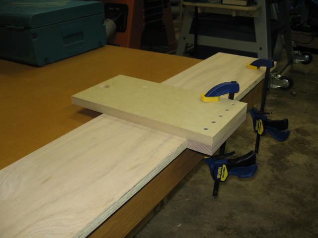

    First, the end panel of the bookcase is secured to a bench or worktable and one half of the jig is clamped into place, with one long edge of the MDF aligned with one edge of the required dado. Note how the hardwood fence indexes against the workpiece, making the jig halves self-squaring.

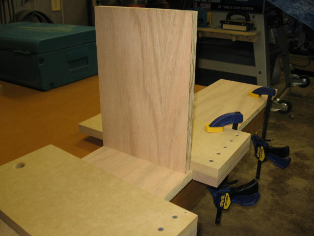

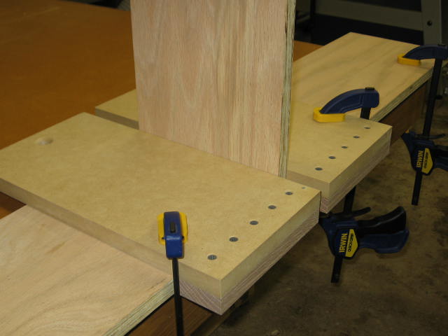

    Next, a scrap piece of shelf material is set into place as a spacer to properly locate the other half of the jig. This is a foolproof way to ensure that the width of the dado will exactly match the thickness of the piece it will receive.

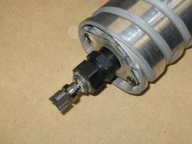

    The dado will be cut using a top-bearing pattern maker's bit. This one is 5/8" diameter, which works well for 3/4" plywood, whether it is slightly undersized or a full 3/4" thick.Click image for larger version

    The spacer is removed and the dado is cut with the bit's bearing riding against the edges of the jig halves. The first pass is made by running the bearing along the edge of one jig half. The second uses the other jig half and widens the dado out to its full, correct width.Click image for larger version

              Should work great, Larry.
              the only issue is it will have to be a very short top bearing bit. Like less than 3/4" from the bearing to the cutting edge and therefor the cutting depth has to be around 1/2" or less - more like a dado cleanout bit than a top bearing pattern bit (which is usually used to clean up a close-sawn bandsaw cut piece to a template.) Most people don't have this bit but they can be bought.

                  Larry,
                  Is that pettern bit 1/4" or 1/2" shank? I am trying to find it on Amazon to use as a filler to get free shipping.

                    Jarhead, that one is 1/4" shank, 5/8" dia, 1/2" cutter length. It's a Whiteside, though, and at a cost of around $22-24 it's going to be a bit more than "filler" unless you can find a cheaper brand.
