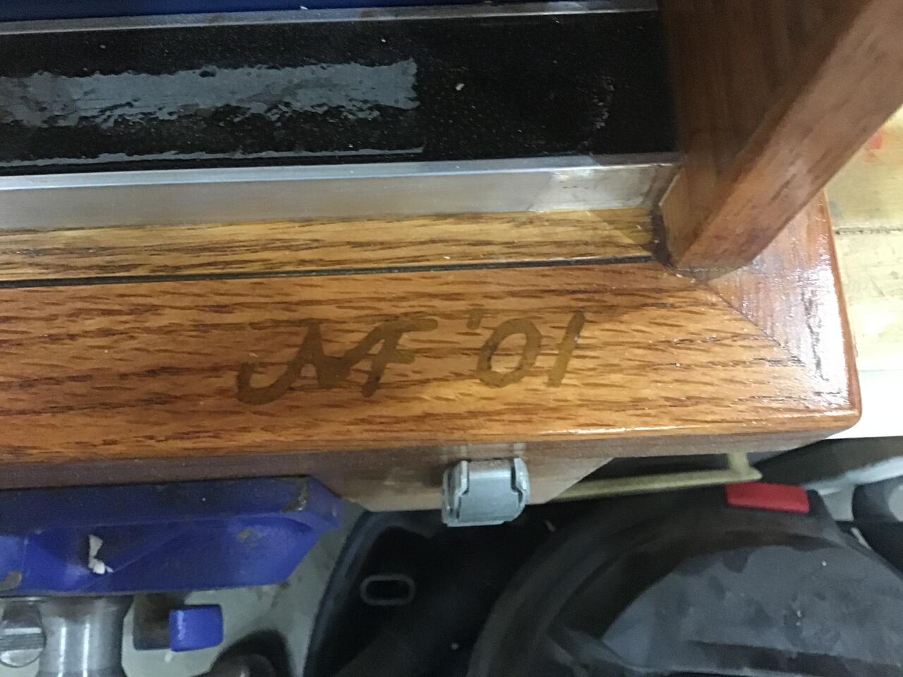

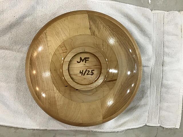

    Normally, I sign my work in one of two ways. Furniture gets a paper label soaked in varnish, glued to an inconspicuous place, and then varnished over to seal it to the finished piece. Smaller things that will be handled get my initials and the date carved into the bottom and then infilled with wood putty, sanded flush, and varnished over. I had the bottom of the newly turned bowl carved and discovered I had no wood putty, so I mixed up some glue and maple sanding dust, and troweled it in. The resulting fill doesn't look anything like the maple bowl bottom surrounding the inlay. Stupid me, again.

    I’ve had that happen too when the filler didn’t match the wood. Next time, I’d check Lowe’s for better color-matching putty, and their return policy makes it easy to swap if it’s not right, so you can get the finish looking exactly how you want without wasting supplies.
