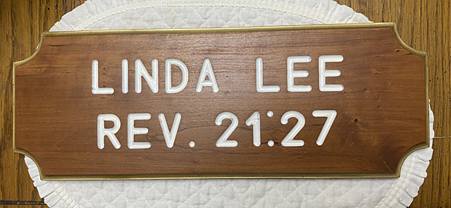

    Well, I got around to making a sign for LOML. My first one, first time ever doing this. It wasn't that difficult and I learned a few tricks that should help me in the future. Tomorrow - Sunday (6th) is LOML's birthday, and this is one of her presents. She doesn't know about it yet, but our daughters have seen it (text message pictures) and suddenly I have been inundated with requests and I haven't even given the first one away yet.
    This sign was done with the 1 1/2 inch letters. Used some cherry that I have had on hand for ages, at least 40 years. I have a Grizzly 9" thickness sander and used it to get it smooth on top. And I kinda "cheated" in painting the top with white letters. I sprayed the top with white and didn't bother to tape it off. Then ran it through the thickness sander a couple of times and took off the paint that was not in the letters. I did similar on the gold edge.
    One adjustment that I will make for the future is make my on "colon" guide as the one in the photo is too far apart top to bottom.

    OH, one spot that sticks out is the "A". The small island is a tad smaller than it should be, rather it should be 1/8" taller but the wood had a small crack in it and the "A" chipped at the crack.

    BTW - I have the 2 1/4 inch sets also, and the 3 3/8ths on order.
      • 22085
      Looks really nice.
      Flat bottomed bit?
      Is the Cherry Naked or did you apply some clear coat?
        • 8803
        Router Bit: I forgot to write that in - 1/4 inch core box.
        I applied clear lacquer -satin
