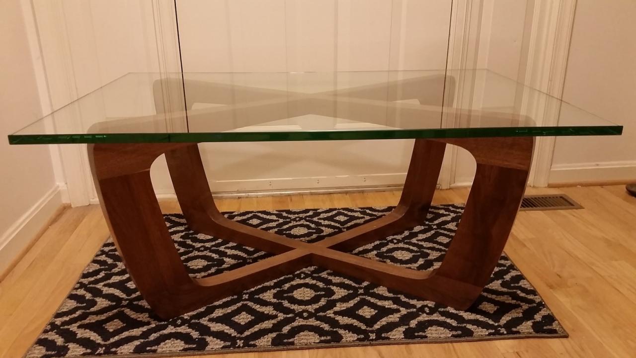

    I've owned these 2 large rectangular glass table tops for almost 10 years but never found a base I liked for them. After some image searching this summer, I found what I was looking for. The challenge for me was to build the table so I could disassemble it and keep it flat for shipping--we are moving overseas and I want to take this with me to remind me of home.

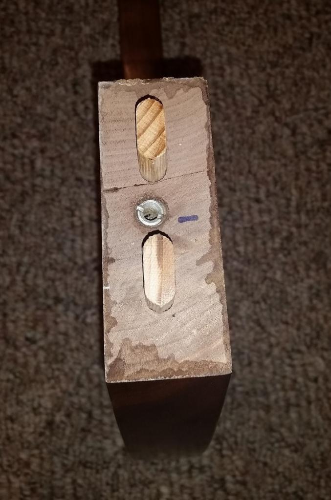

    It's made from walnut milled from a storm tree from my neighbor's yard--same wood I've been making a lot of projects from. It started as 8/4 walnut. Construction was fast and the pieces are held together with domino floating tenons. One of the pieces are also secured with a threaded insert and bolt--no glue.

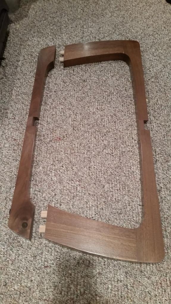

    The two halves are identical--I created a plywood template I use to route the final legs to final dimension. As you can see, one of the legs comes apart so the table can be disaasembled.

    Before glueup I also had to cut angled half-laps. A little nerve racking, but I got it done with my miter gauge and regular saw blade--lots of passes. Something I learned from someone else's mistake is to do the final sanding before cutting the half lap. My friend sanded afterwards and then had gaps at the half laps.
    I'm pleased with the final result and today I submitted it to the county fair for judging.
    I'm also going to make one for my Uncle who has a new house but a bare living room.

    I suppose the screw hole in the joints are hidden by the rubber glass stopper? Are there any screws in the half lap joints?
      No. The bolts only come up from the bottom for that one half of the base assembly. The top part of that base is glued to the legs. The other base assembly is completely glued and does not separate. The rubber feet for the base do not cover the holes on the bottom. The rubber feet are screwed on. However, when the table is fully assembled and with the 70lb glass sheet on top, I think it's impossible to tell that the base disassembles. The dominoes and the bolt draw everything tight and the joint feels flush. Although not pictured, there will be round vinyl discs placed between the glass top and the base.
      There is a single wood screw near the floor that holds the bottom half lap flush. The top half lap is tight enough that a screw isn't needed top keep the two pieces flush to each other.
