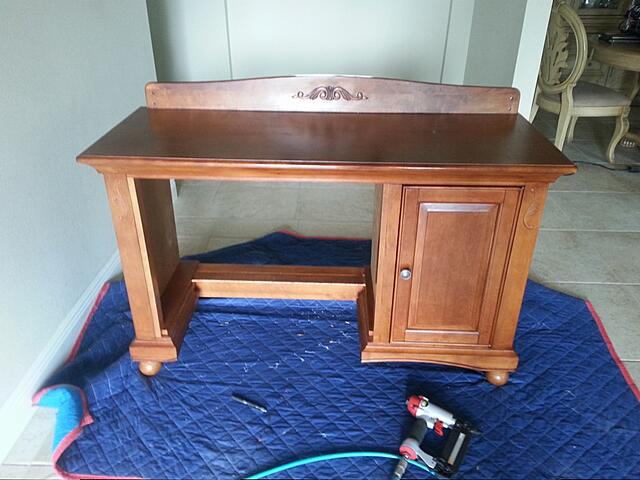

    Hi all, had some time to get some woodworking done, maybe not in the truest sense, but its wood and its work ;-)
    I converted the oldest child's changing table into a computer desk. The molding on the bottom was quite tricky, in the end I marked and cut and hoped for the best knowing that we had already gotten our money's worth out of the unit. Took out the upper swing out drawers and the lower drawers, webbing, etc. Used the slats from his old crib side rails and the lower rails to finish off some rough edges and voila.
    Click image for larger version  Name:	20161115_142018_zpszdplbyxu.jpg Views:	1 Size:	462.5 KB ID:	828279

    Hey, good to see you around! I like the repurposed table. Waste not, want not.

                  That was a fantastic use of recycled wood with sentimental value to boot! I'm a big fan of repurposing stuff.
                  The desk looks great.

                    I missed this the first time around - that desk looks awesome!
