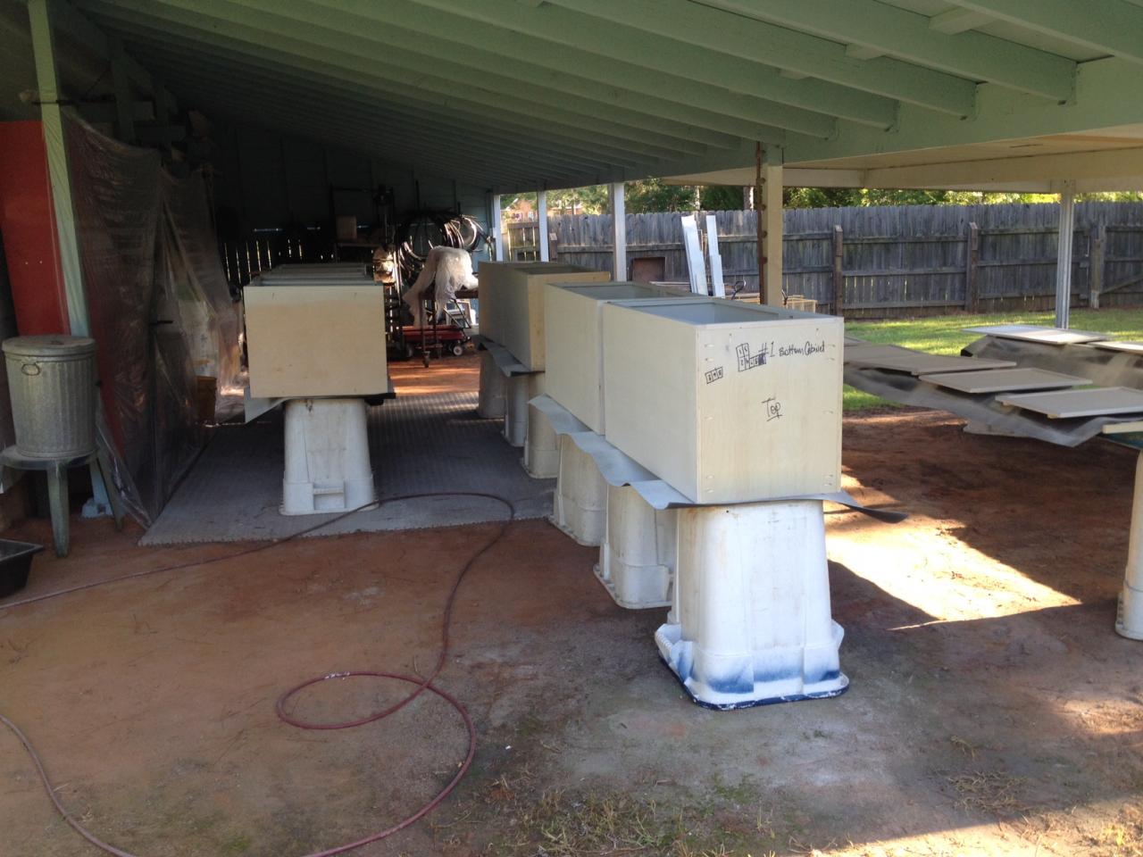

    on to paint
    • 3791
    Phase 1 cabinets in the "paint shed"

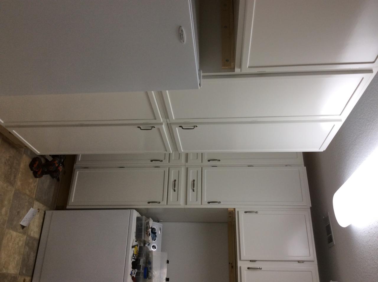

      • 3791
      Phase 1 cabinet installed, not on the side like the photo shows, though it would have been easier.

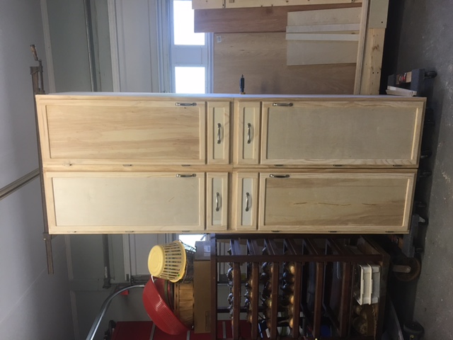

        • 3791
        Phase 2 cabinets build in shop. These cabinets were brush/rolled painted in shop rather than spray like phase 1

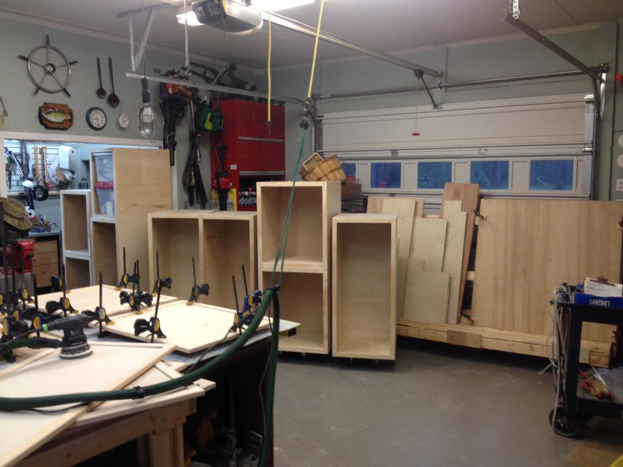

            • 3791
            Phase 3 cabinet build in shop

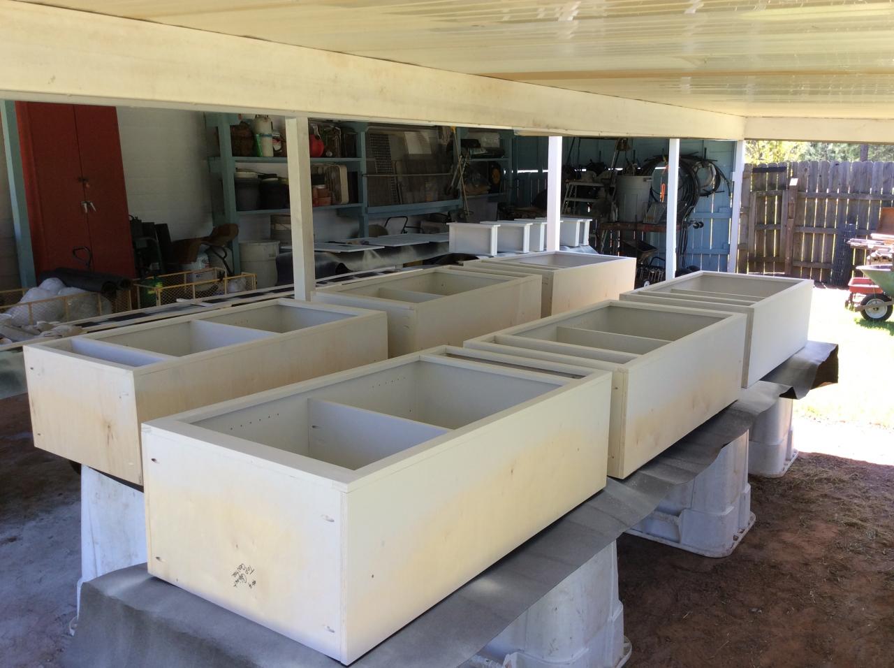

              • 3791
              Phase 3 cabinets in the paint shed

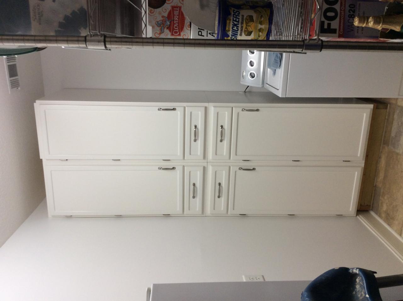

                  • 3791
                  Install complete, sorry about the photos being on their sides..... That's the sawdust zone way, so get over it!
                  The cabinets are 8'6 tall making photos difficult to say the least.
