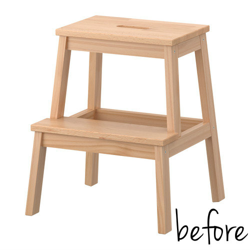

    The base - an Ikea stool $15.
Name:	ikea stool.jpg
    So I bought a stool. I thought it would be easy to clone - it was actually difficult with compound angles all over the place.
    I did make one successfully but $15 would have better deal!

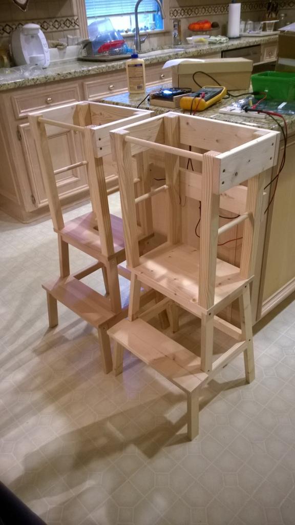

    I built two tops, one bottom stool, one stool from Ikea.
    I'm going to add a small shelf on the front. Pictures are in my kitchen, with the shelf, the top should be about level with my daughter's reported countertop height.
    Anyway, interesting project.

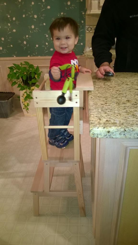

        • 22109
          Cool idea. I like the little shelf added to the top/front. It should keep fingers from getting pinched.
          Good thing you ohmed them out before putting them into service. Safety first!

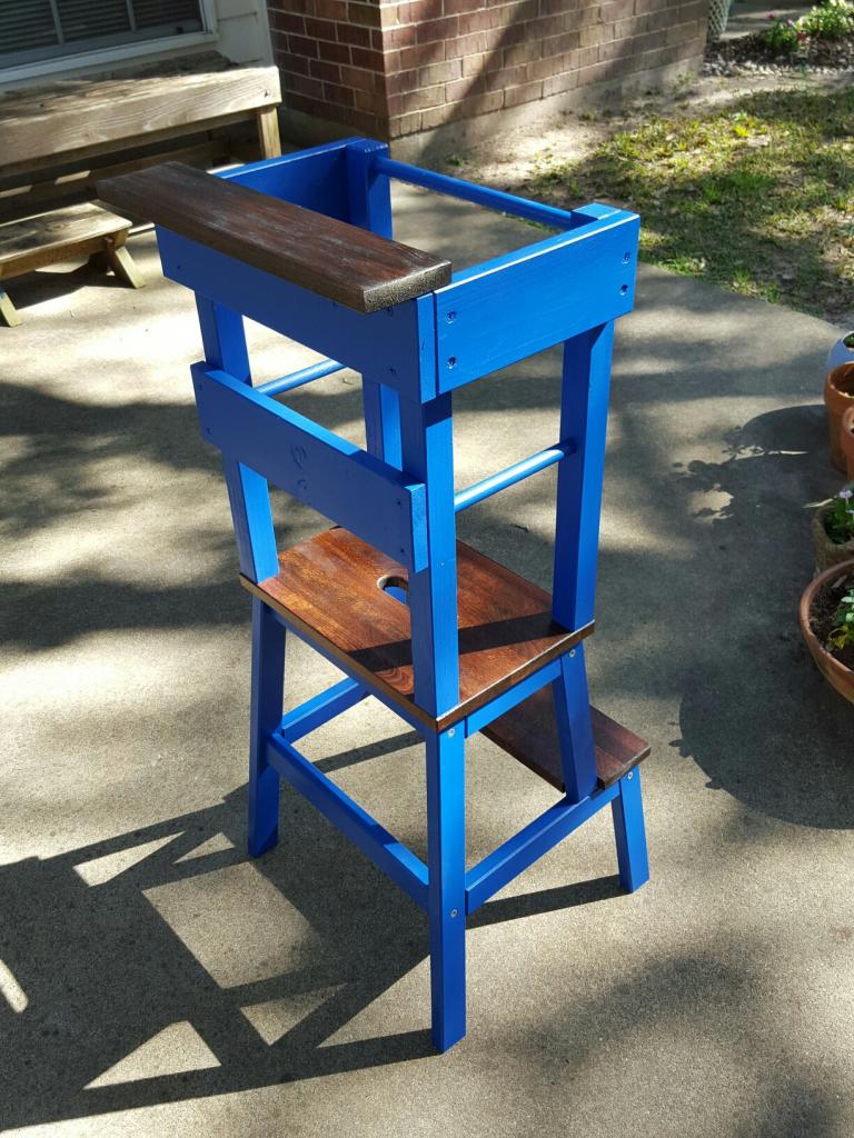

              Here's what it looked like after daughter applied paint and stain finishing:
