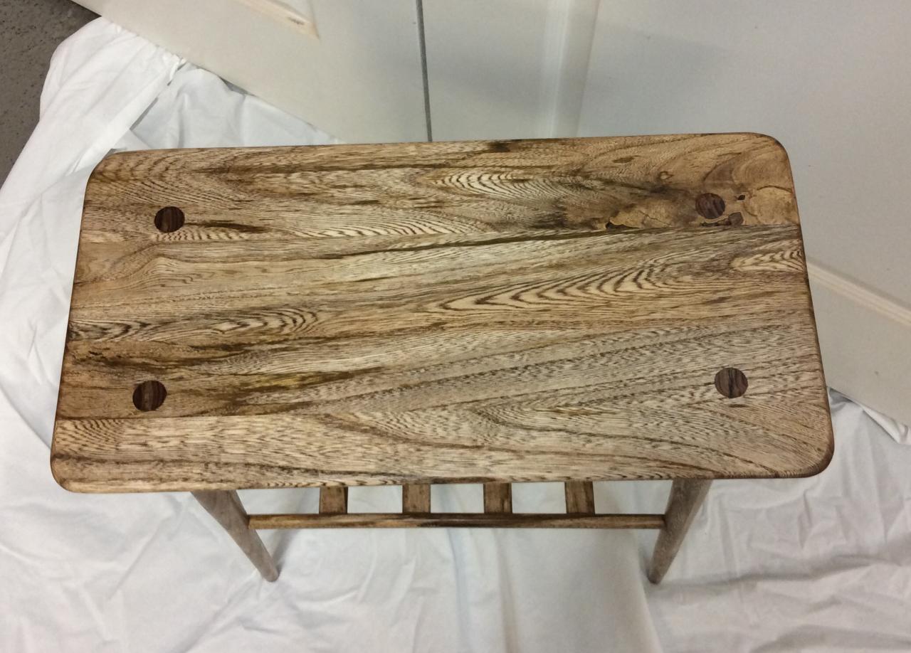

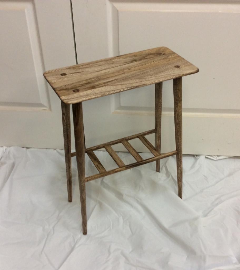

    This table uses some more of the 3 crooked, warped and cupped Black Gum Tupelo boards that I was able to mill out enough scantlins to cobble together another table from these beautiful boards. The legs are round 1 1/4 X 5/8" x 24" long and consist of a glued up stack of 3 thin strips and is the first Tiny Table legs I've turned. This dried wood does not turn well and turning this long of a piece creates quite a pucker factor when it starts to chatter. I also tried to turn a 1" X 1/2" X 28" leg but It was so flexible I shelved that project for later. The shelf is 3/4" X 1/2" and 1" X 3/16" pieces.

          How much time? The last 4-5 Tiny Tables that I have built have all been experimental to see how it looked, how the customers respond to them and trying to figure out different techniques to build and joint. Most of my time is spent preping the wood. I've probably invested 40 man hours in milling, planing, sawing and glueing up the first 3 boards. I'll probably be able to get 4 tables out of these boards. This table took about 12 man hours to build and finish, 6 of which was turning the legs. I tried to turn the legs (1 1/4" X 5/8" X 24" ) with a "knot" in each leg that I could form to meet each shelf stretcher to give it a look that it was all one piece. Way too much work doing that and would have probably ended up messing up a leg and throwing them all out. If I could find this wood in good flat and straight condition and not warped, cupped and crooked I believe this table could be built in 6-8 man hours. Not much profit here but it is good experience and gives me a chance to do something I like. I get some requests for larger tables and furniture but I decline the request because I don't want to deal with builds that I can not pick up and move around by myself. There is definitely better money in larger tables though, the one I built for Christmas last year sells for over 1k at several local shops, when they can get one in stock.
          The legs are not tennoned, they are doweled. The top of each leg is cut offset 4 degrees X 4 degrees, the bottom of the table has a socket hole cut 1 1/4" for each leg. I drill a 1/8 hole through the top of the table into the center of each socket hole which lines up with lathe center hole in each leg and I fasten the leg with a 2" screw. This is just to get the legs angle fitted perfect and the stretcher shelf fitted. After everything is fitted and glued I remove and glue the legs back in the socket and reinstall the screw. Next day I remove the screw, drill out the hole into the leg and install a 3/4" X 2" dowel. My tests showed that this held up better than a thru tennoned legs where the table top would split or the leg would just pop out. This meathod the leg would split at the table socket but would not break without several good whacks against the floor. This meathod is a lot easier than trying to bore the table top at 4 degrees X 4degrees and making the tendon on the end of the leg.
