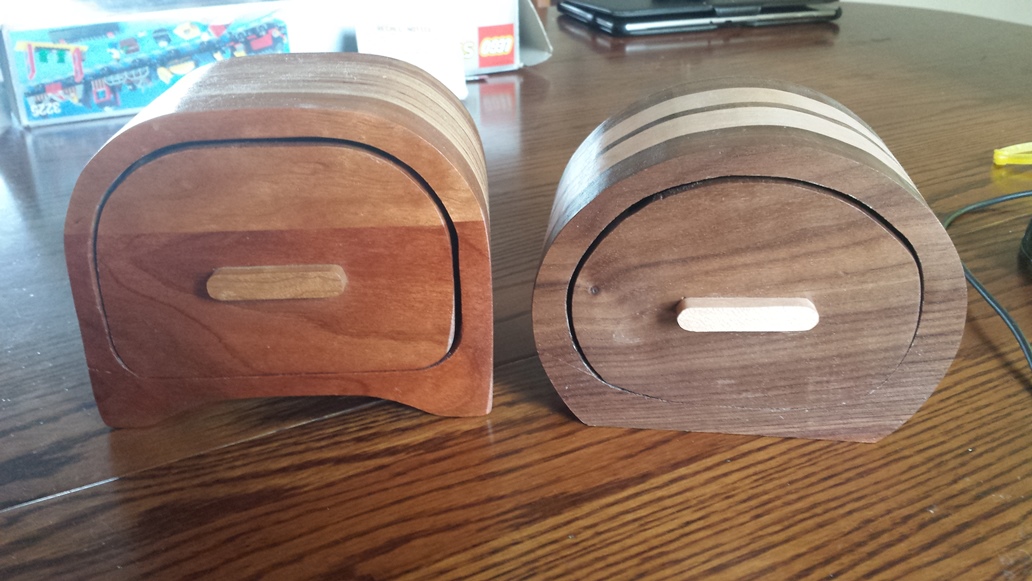

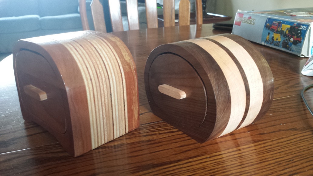

    This year I finally tuned up my band saw and started some band saw boxes. I have the Craftsman 10" BS, so it's a little small and underpowered, but with the right blade, it does OK. I have some work to do to get better and cut better with it, but it's a lot of fun.
    I used two plans from David Picciuto, the Drunken Woodworker:
    http://www.drunkenwoodshop.com/
    I made the Austin and Omaha. I use a lot of DW plans. He's a local guy and I like his projects. I made these over the summer and the kids really like them, so they are a little beat up.
    I need to work on disguising the kerf entry cuts as well as just following a line without wavering. Overall I am happy with them. The drawers are loose, but that will improve with technique. The one on the left was my first and I used scrap bin cherry (didn't even realize the front was a glueup until I finished it, LOL) and laminated 1/2" ply and the right one is walnut and maple.
    Both are finished with simple spray lacquer.

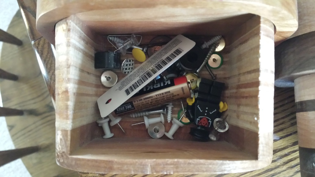

    Those look great. What is the drawer capacity on them?

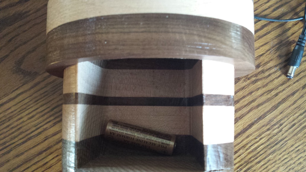

      Not huge. On the maple/walnut box I miscut it and made the opening too small and uneven. I also did not sand them on the inside. I was (am?) thinking about trying to flock them. I have also seen people flock the inside of the box opening, which helps shrink the gap so the drawer fits more snug. I've never used flocking, but can't see it helping that much, especially on mine with huge gaps.
      These are just "practice" so I may continue the experiment with flocking.

            Flocking the drawers is really simple. A tad messy, but simple. I have a large cardboard box, maybe 20 x 20 inches, and 6 inches deep that I stand on end to make a "flocking booth." This catches the "overspray" so it can be recovered. That stuff isn't cheap.
            As for gaps between the drawer and carcass... my lessons learned with the handful of boxes I've made:
            * Sanding widens the gap so do the minimum you can get away with. Being very careful while sawing helps since there is less to correct via sanding. I learned that curved edges in the pattern are your friend... if you drift off the pattern line a little - such as making a slightly too-tight radius - keep sawing to that new radius as much as possible rather than trying to quickly recover the line. Recovering quickly just introduces a hump or wave that stands out... or needs to be sanded a ton.
            * Is the drawer riding on anything? I glue some felt strips inside my bandsaw boxes for the drawer to ride on. Does 2 things: makes the drawer feel smoother when opening/closing, and it "lifts" the drawer - increasing the gap below the drawer and reducing the gap above it. Done right, you can equalize the gap all the way around with a little felt (or flocking) which makes everything look better.
            * bigger gap? A larger radius roundover may help hide it.
