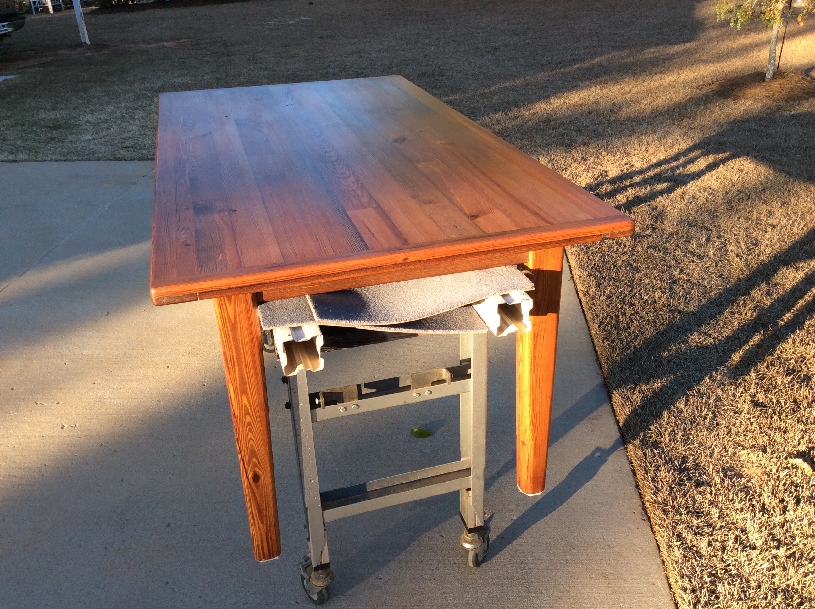

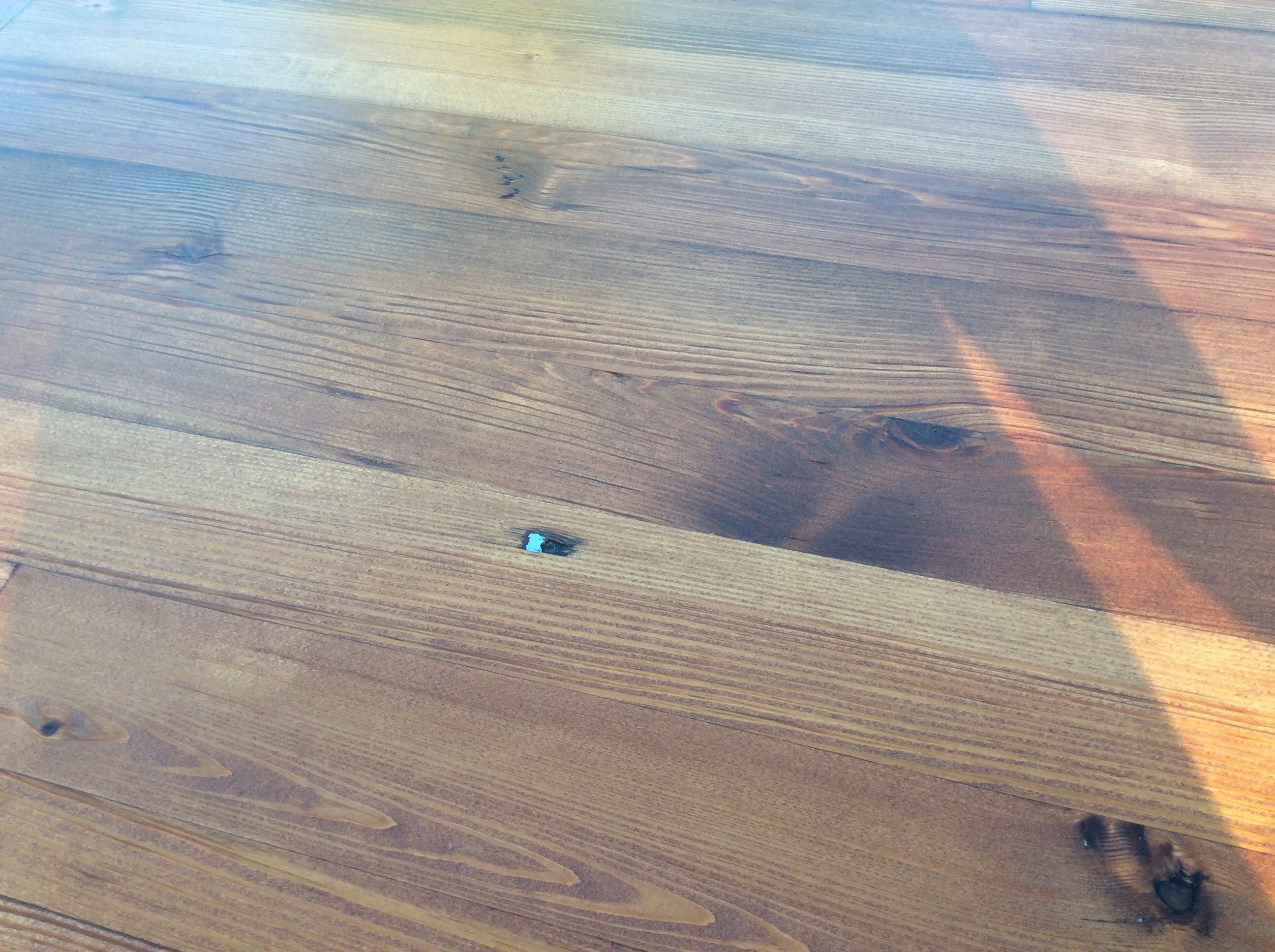

    Finished at last! 4 weeks build time. Antique pine dining room table. Wood salvaged from an old family barn in S. Ga. Wood was payment for building a co-worker for a Christmas suprise table for his wife several years ago. Most wood was cut from 8"x8" barn timbers. Size, 70" x 32" , built to fit my dining room and replace the existing 40 year old table. This table top includes a bullet that was imbedded in the wood. Top is floating to compensate for wood movement, and has shrunk about 1/64" since the top was glued up! Finish is wood conditioner, red oak stain, Danish oil and Butchers wax.

          Looks great! I like the choice of finish. Hope your wife will love it (and you for making it)!
            • 8793
            Old wood sure makes great furniture, and a skilled builder enhances it even more! Great looking table! Congratulations!
              Very nice.

                Beautiful table. It really would go better in our house than yours...but I guess I won't be getting it.
                  • 3774
                  The tables that I have previously built suffered from some expansion/contraction issues although I followed existing table building practices. Lots of research later I tried a little different approach from what everyone does on the Internet. To complicate things my wife wanted a breadboard look. When boards expand the table width increases and leaves the breadboard ends short, making all 4 corners look bad. Not much that can be done about this. What I didn't want was a warping table so I built a floating table slab using a different attachment method. This wood is very old, and some of the boards have over 14 growth rings/inch. Our best guess is the wood was cut in the late 1800s and was possibly I've 100 years old then. It has been inside my air conditioned shop for over 4 years so I figured it would not have much movement. In the 4-5 weeks that I have cut the 8x8" beams down to usable size and done the glue up for the top slab it has shrunk about 1/32". This is not much but it has left the breadboard proud of the ends of the table top enough that you can feel it with your finger. Not what I thought would happen. At least it didn't pop and bust and warp. This weekend it will be moved into the house and into a different humidity situation, I'll see which way the top moves then.

                          • 3774
                          Uneven ends on the breadboard is understandable by most of us, but try to explain to your wife who still refuses to believe the scratches on her car door at the handles are caused by the diamonds in her wedding ring. It ain't happening.
                          The breadboards on this table are tongue & grooved and not glued. I used the Kreg pocket hole screw to fasten the breadboard in the center of the table and on the outsides I used the Kreg to create a 3/4" wide pocket for the outside screw, and set the screw snug. That allows 3/8" table top expansion each way in the breadboard. Then I added the additional slab board under the slab over the pocket holes to give the wanted 1 1/2" thickness.

                            Very nice! I bet there is an interesting story about that bullet.
                            Richard
                              • 3774
                              My buddy that traded me the antique pine still lives in his grandmothers old house on what is left of the family farm. He says his grandfather always carried a .32 S&W and was know to shoot at the pegions, rats, cats or whatever in the barn with it! Some of the wood that I built his table with came from the farm blacksmith shop. Lots of .22 bullets found and every board had bird shot in it. All of the buildings on the farm are rotting down in place and have very little usable wood left. Most have already been push down. All of this kind of buildings will be gone soon and all we will have is HD wood.
