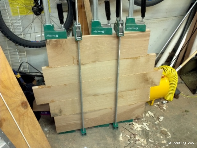

    Glued them together to make a 30" top using Titebond 3.

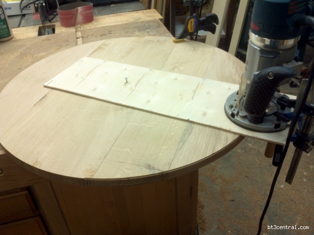

    I couldn't find my double stick tape so I clamped my plunge router to the makeshift trammel and plunged a hole. I measured 15" from the edge of the hole to another point on the trammel and drove a roofing nail through it. I aligned the nail point to the center mark on the top and gave a few more whacks of the hammer to secure it. Then I just started routing in successively deeper passes until I had my perfect circle.

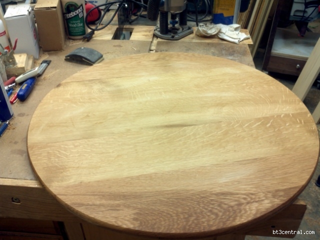

    I then routed a slight round over on the top and bottom edges and just hit it with some sandpaper to just smooth the edges a tad. Here it is with some mineral spirits wiped on

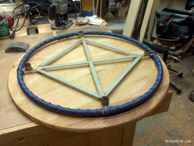

    And with the subbase. There's a 1/2" gap between the frame and top so I'll shim it with some 1/2" stock, drill some oversized holes in the frame and attach the top with some screws. I may peel off that faux blue wicker. I'm going to leave it to my Dad to apply the finish. Milling the rough lumber took the longest, followed by sanding at around 2 hours but everything else was cake. I love quickies.
      Thanks for looking
      Paul
      Allowing for wood movement is something I see missed very often. About 30 years ago I learned the hard way - how much Oak can move on a table against the frame.
        When I first started woodworking 10+ years ago, I took a night class offered by the City of San Diego. It was taught in one of their high school wood shop classes by their shop teacher. Anyway, I made a red oak coffee table and made two cardinal sins of wood movement.
        1) The top, I think measures 3' x 5', has bread board ends. I glued the bread board ends the whole length of the top.
        2) The top is attached to the aprons with screws. I did not drill them oversized to allow for wood movement. I don't remember now, but I think I even have the top and frame attached by glued in dowels, too.
        We use the table in our finished basement here. 10+ years later, I'm still waiting for it to explode/implode/crack. It'll probably happen the second I give it away.
        We may have touched on wood movement in the class, but with 10+ students working on 11+ projects (I made two in that class), I can't fault the teacher for not schooling me on that. I'm glad I have places like here to fill in those gaps.
