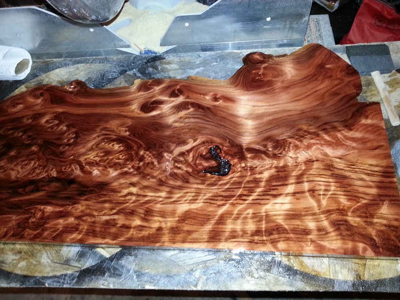

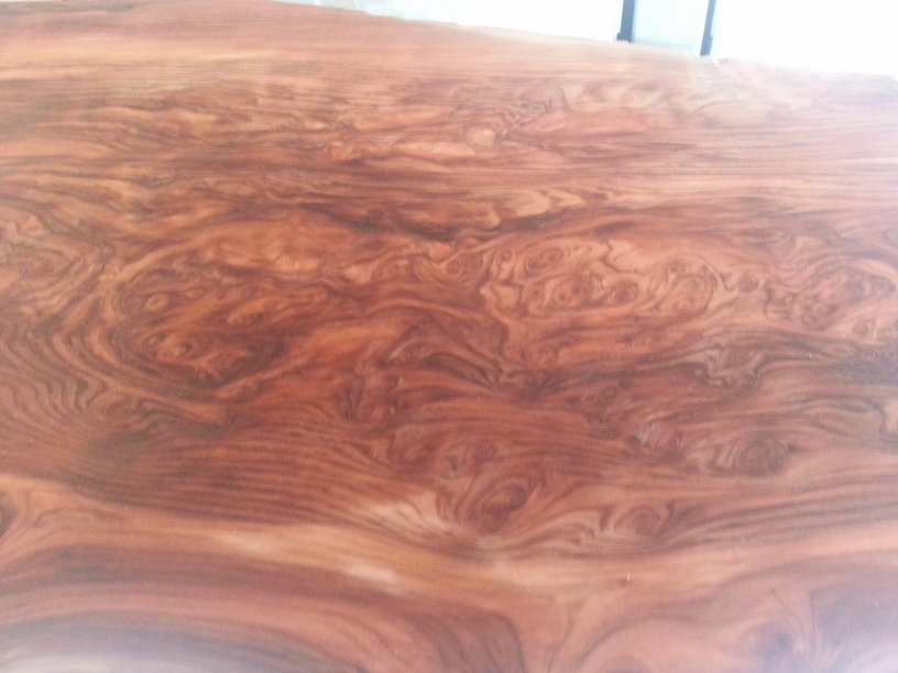

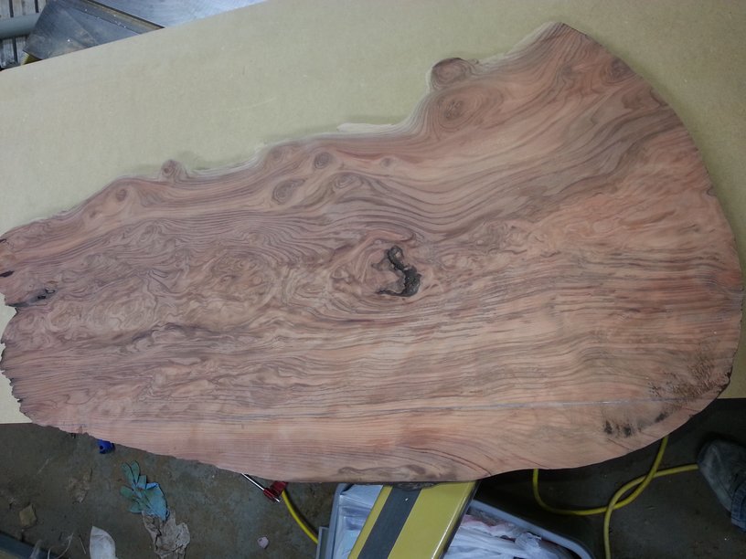

    I posted about this a bit ago, but only when I was looking for a supplier for a decent sized slab and then I needed someone to help me with a drum sander (THANKS BRIAN!)
    But here's the finished project.

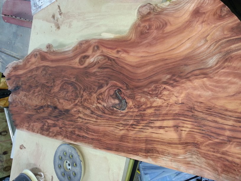

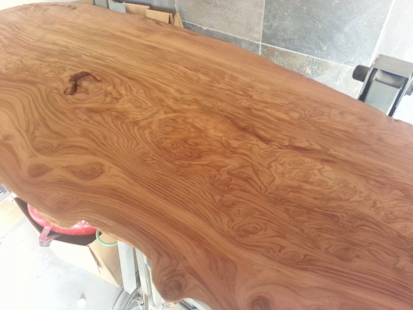

    I didn't take any before pictures, but the slab as I received it was pretty rough. I tried using my hand planes, and quickly re-affirmed that I have no idea how to use my hand tools (yet). Luckily, a forum member local to me was nice enough to invite me to his shop where it must have taken 40-50 passes to get the whole thing flat across the width of the slab. I also was able to see some great work, which hopefully I can eventually approach with my own work in the future.

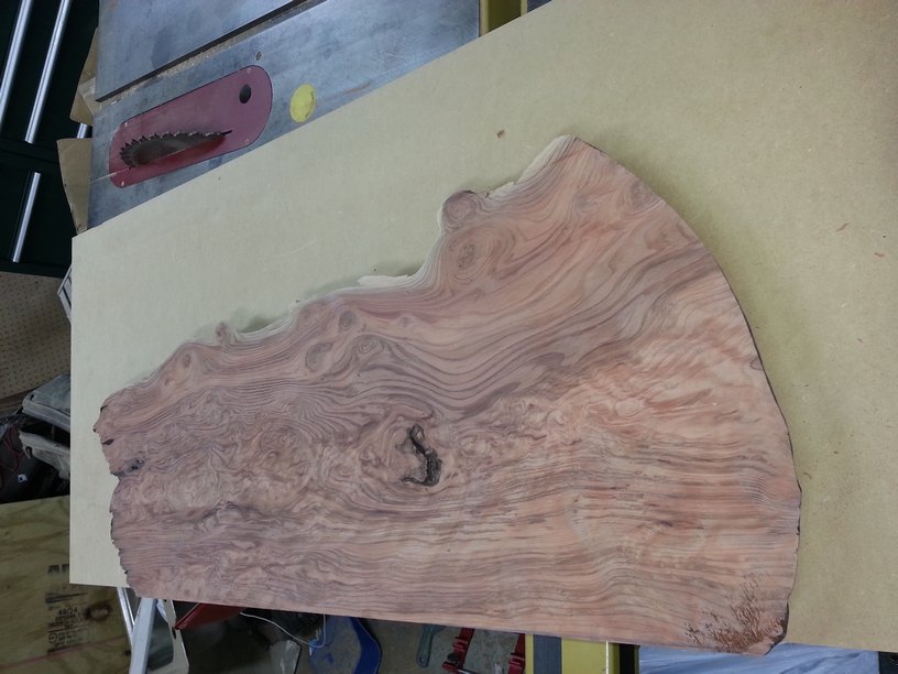

    Then once that was completed, I needed a straight edge to go against the wall. Since once side was a live edge, I cut the flat by using double sided tape and affixed that to an MDF board. That worked really well, and I got just the cut I needed.

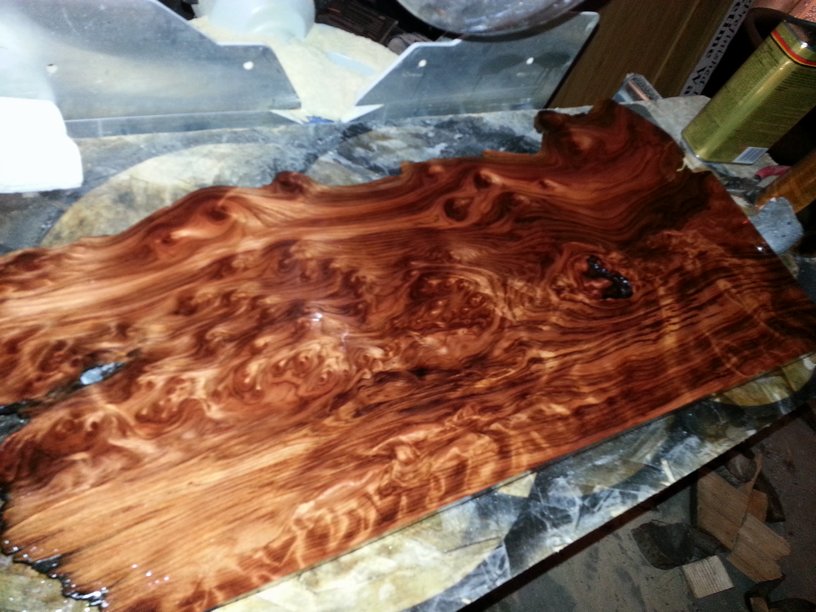

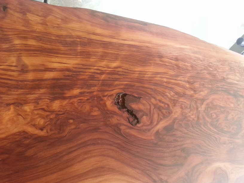

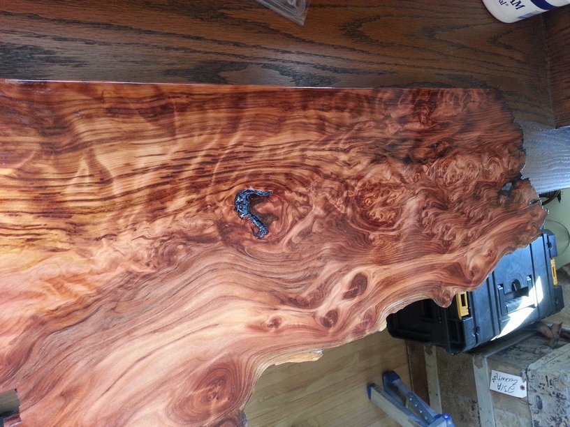

    Some more sanding to bring it up to 220, and a light wipe-down with mineral spirits. Then I applied many coats of oil based poly (wanted to darken it, plus it had to be able to handle some light moisture).

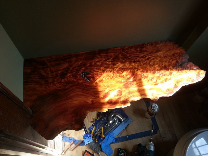

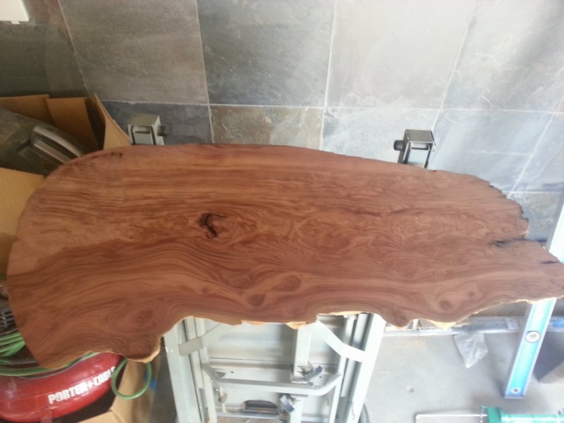

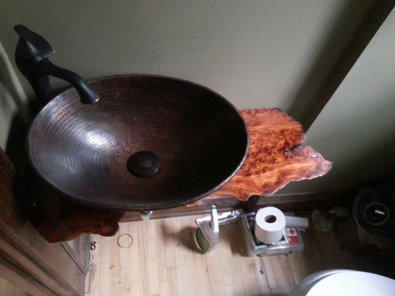

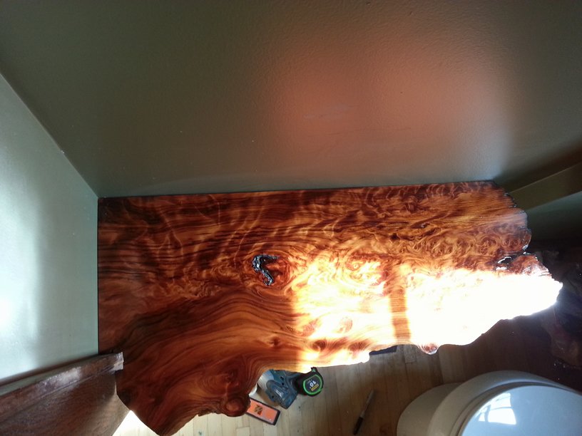

    I mounted it to the wall using some small shelf brackets that fit the look we wanted. I then drilled holes for the sink and the faucet (definitely was something I measured many many times over- can't go back once you've drilled out with a hole saw).
    Overall, I'm extremely happy with the result. I'll post pictures with the house completely done, which won't have a mess of tools in the frame. But for now, hopefully you all appreciate it.
    Thanks!

      that's.... one.... gorgeous.... piece.... of ..... wood !!!!

        Beautiful piece of wood and the sink and faucet goes great with it. Good job you have every right to be proud. Very rustic looking
          Beautiful!
            My thoughts, exactly!!

              Wow! That sure finished out nice. Glad I was able to help. In retrospect, we probably would have been done faster and with fewer passes if I had started with a coarser grit. Gave us a chance to talk, though.

                I wouldn't have had it any other way- it was a very enjoyable afternoon. Thanks!

                    That is one heck of a job. If that was in my bathroom, I'd be afraid to use it.

                      Holy burl, Slab Man! That's sweeeeet. (Mentally calculating the number of pen blanks hidden therein... )

                        Very nice slab. Almost (but not quite) a pity to use it as a vanity... But it sure does work well there!
                          beautiful piece of wood. I hope you can see it in the finished installation - but I think you can. Well done.
                            No reading material required for that throne! I could admire that slab for hours! Well done.
                              I would tell people that they can visit the bathroom but not really use it! Admire only!
