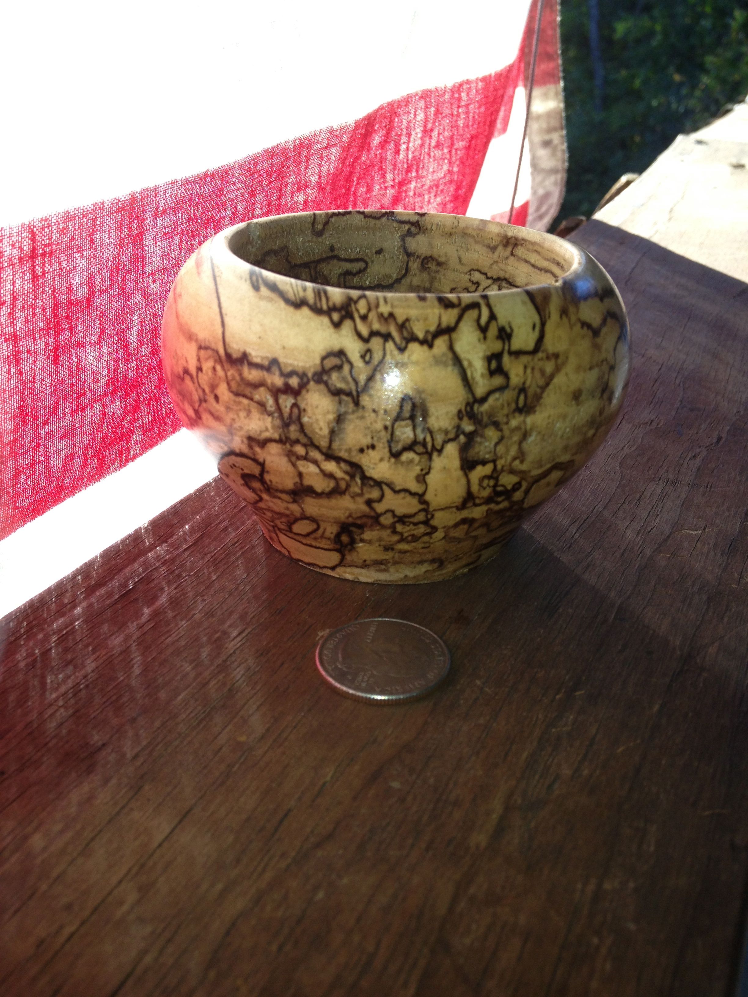

    It was a nice day and with the sun shining I brought the lathe outside to have some more fun with firewood.
    This firewood was spalted maple I came across at the splitter. Very hard, very dry. Had to make more than one trip to the sharpener to get this done.

    Very good!
    Did you attach to a faceplate on the lathe?

      that looks amazing.
        Incredible spalting and great workmanship!

          That look great! You put those sharp edges to good use.

            Originally posted by rcplaneguy
            Very good!
            Funny you should ask. I was trying for a live edge bowl but the outside of the wood was so punky that the screws didn't hold the blank to the face plate. I was just about to throw it back in the burn pile when I decided to try turning it on centers. That ended up working well enough for me to form the shape and turn a foot for the 4 jaw chuck to grab on to.
            Thanks for the kind words folks.

              I see the quarter for size comparison, is it about the volume of a shot glass ? If so, a couple of shots with that and you can make a whole set!
