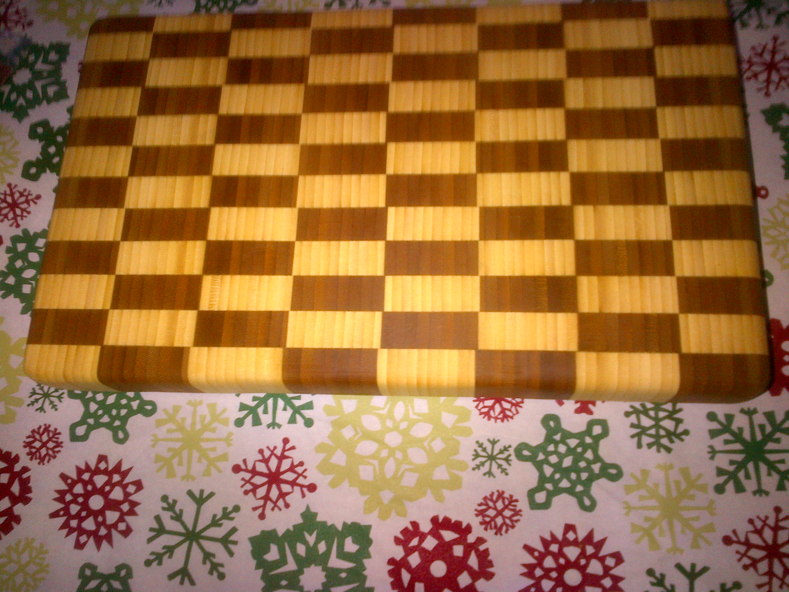

    Well I finished two of the 4 boards I need for Christmas. Pictured is the one I am giving away in a "Gift Exchange" with the Hostage Negotiator Team I am part of.
    It felt good to get back in the shop after a while. Board is end grain bamboo finished with mineral oil

      How did you do the coloring?
        The dark color is something called "Caramelized ". My understanding is that the bamboo is heated bring out the sugars making it darker.

          Where did you get the bamboo boards? I have heard of a few places that sell it as a ply sheet material...
            I got the boards from Dakota Hardwoods. 8 foot by 12 inches. $65 a board.
              Not cheap stuff...$8/ft. Board looks great...well done. Will they all be the same?

                The two I am making for my kids are about twice as big and just striped, not alternating.
