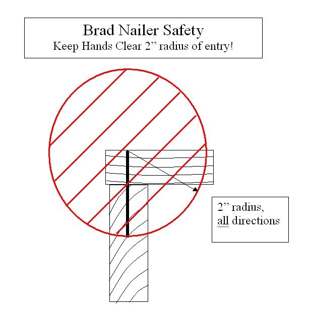

                        A word of caution on air nailers that no one has mentioned. Keep your free (work holding) hand out of the line of fire of the nail/brad, or at least back as far as possible from the joint. nails/brads, especially 18 ga and smaller brads tend to follow the grain of the wood and will sometimes exit at an angle. If your hand is over the joint it may temporarily become part of the project. Of course you could always claim that is not a blood stain, it is a DNA signature!
                        There is also the posibility of a double fire with the nailer. If the head jumps the second brad/nail may miss the wood completely.

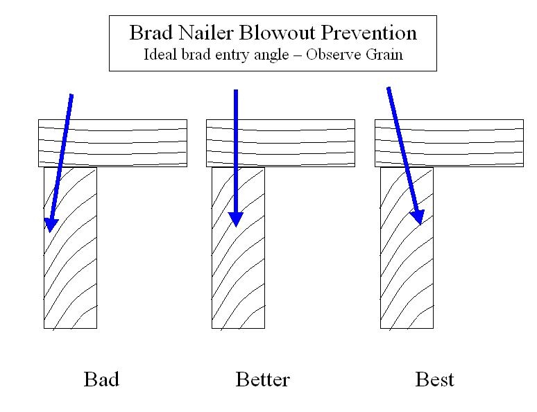

                          this is what Pappy was talking about. Be careful with air nailers. They can turn the brad around 180 degrees and come back at you if the grain is right.
                          see how this brad followed the grain?
                          Here's two pictures I posted once before:
                          Blowouts like this don't happen too frequently but they can happen so you need to keep a brad's length away from any possible course from the point of entry.
                            Looks like the brad went right through the summer growth ring, but when it hit the late growth (harder), it bent the tip of the brad - see photo - redirecting is along the grain through the summer wood.
