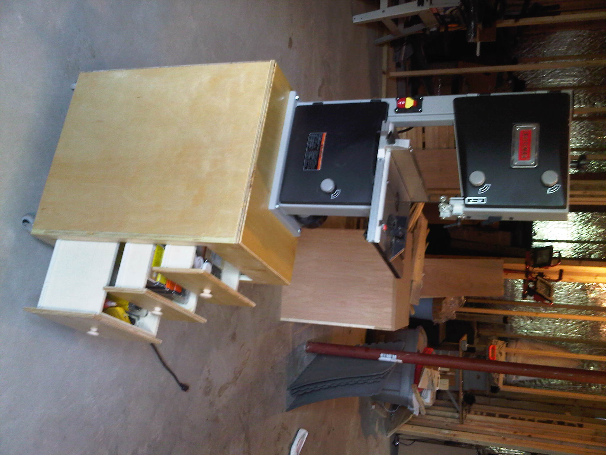

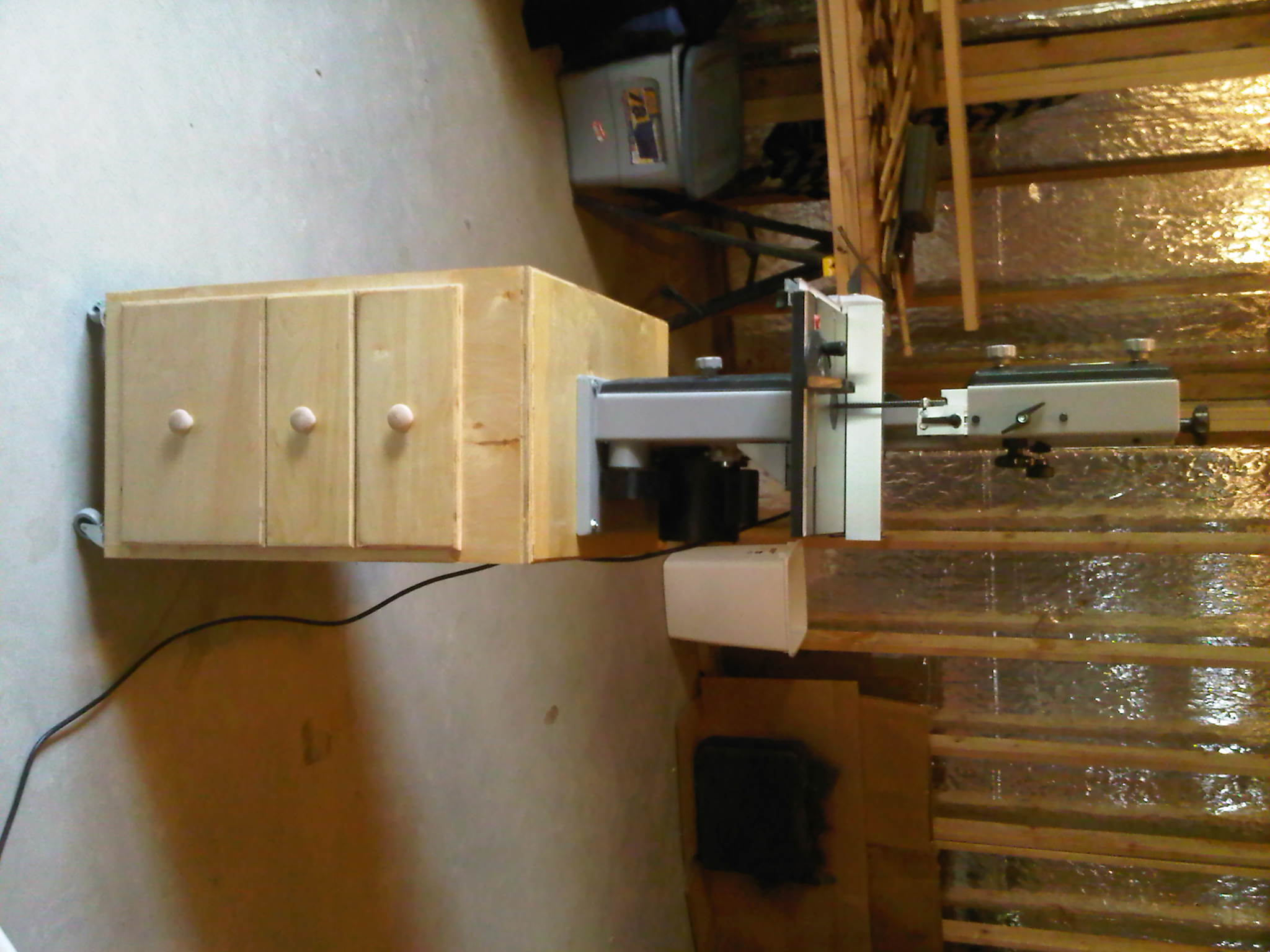

    I finally got a chance to get some pics of a new stand I built for a Christmas present--a 10" Craftsman bandsaw. It's also my first adventure in building "nicer" shop cabinets with drawers.
    The stand is built of 3/4" Birch plywood and features 3 drawers for storage which are two 5" drawers and one 10" drawer. The cabinet is a faceframe cabinet (built from Tom Clark's Practical Shop Cabinets method). The drawers are made of 1/2 ply with 1/2" false fronts that overlap on 18" self closing slides. I routed the edges of the top and fronts with a 1/4" roundover bit, which came out ok--I really just wanted to eliminate the sharp edges. The project is finished with 6 coats of Minwax Wipe-on Poly sanded with 220 between the coats and 0000 steel wool as the final sanding. The 2" casters allow it to roll smoothly where I need it. With the cabinet loaded, there are no issues with tipping that I have experienced. Rather than using locking casters, I chose a method for locking the wheels that I am beginning to find more user freindly--I simply cut some 2x4 wedges and attached rubber shelf liner to 2 sides. A simple "kick" of the wedges on two sides stops the movement of the tool and I don't have to bend over to unlock them. It probably wouldn't work for a heavy bench, but for something like this, it works well. All in all, not a masterpiece and certainly not fine joinery, but for me a good learning experience. Hopefully the next one will be better

    Looks nice once I get the crook outta my neck nice job

      nicely done dual purpose stand/cabinet.

          Nice job. I have the same bandsaw. I didn't think much of it at first, but after obtaining a 1/2 inch 3tpi new blade I am quite happy.
            a pic or two of those wedges and how they are employed would be appreciated. i would like to immobilize a bench i have that's on 4 non locking swivel casters and haven't found anything particularly reliable yet. another forum member noted that he had a way to do it, but his explanation made it clear he had no real intention of sharing any meaningful information.

              I have that BS and love it. Congrats.
              Here is a great article on tuning it if you haven't seen it yet:
              http://blog.woodscrub.info/2008/01/t...-band-saw.html
                I think 'nicer' shop cabinets is an apt description.

                  Thank you for the kind words. I'll try to get some pics of the wedges soon. Also, thank you for the link on tuning the saw, I had not seen that one.
